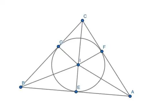

Derivation: Given $\triangle ABC$ and its incircle $\Im$ with inradius $r$, we have the known (and easily provable) formula $$\tan \frac A2\tan\frac B2 +\tan \frac B2\tan\frac C2+\tan\frac C2\tan\frac A2=1.\tag{1}\label{1}$$ We know, $IE=IF=IG=r$. Now, $$\tan \frac A2=\frac{r}{AE}=\frac{r}{AF}$$$$\tan \frac B2=\frac{r}{BE}=\frac{r}{BG}$$$$\tan \frac C2=\frac{r}{CG}=\frac{r}{CF}$$ Putting appropriate values in the formula $(1)$, we get $$\frac{r^2}{AE\cdot BE}+ \frac{r^2}{CG\cdot BG}+ \frac{r^2}{AF\cdot CF}=1$$ or $$\frac{1}{AE\cdot BE}+ \frac{1}{CG\cdot BG}+ \frac{1}{AF\cdot CF}=\frac{1}{r^2}$$ Finally, using the identities $\Delta=rs, s=\dfrac{a+b+c}{2}, \Delta=\dfrac{abc}{4R}$ (where R is the circumradius) and the sine law we get $$\frac{1}{AE\cdot BE}+ \frac{1}{CG\cdot BG}+ \frac{1}{AF\cdot CF}=\dfrac{s^2}{\Delta^2}=\dfrac{(a+b+c)^2}{4\Delta^2}=\dfrac{(a+b+c)^2\cdot 16R^2}{4a^2b^2c^2} $$ Thus, $$\sqrt{\frac{1}{AE\cdot BE}+ \frac{1}{CG\cdot BG}+ \frac{1}{AF\cdot CF}}=2R\frac{a+b+c}{abc}$$ $$=2R\frac{2R(\sin A+\sin B+\sin C)}{8R^3\sin A\sin B\sin C}$$$$=\frac{1}{2R}\left(\frac{1}{\sin B\sin C}+ \frac{1}{\sin A\sin C}+ \frac{1}{\sin B\sin A}\right)$$ so that $$2R\sqrt{\frac{1}{AE\cdot BE}+ \frac{1}{CG\cdot BG}+ \frac{1}{AF\cdot CF}}=\left(\frac{1}{\sin B\sin C}+ \frac{1}{\sin A\sin C}+ \frac{1}{\sin B\sin A}\right)$$

  • Where are the cevians @TheBestMagician? AIG, BIF and CIE (If that’s what you are referring to) are not straight lines. – insipidintegrator Jul 14 '22 at 16:12
  • My bad, I was being a bit silly. The idea still may work, however, if you draw in the angle bisectors and use ceva that way. You can find the distances between the tangency points and the feet of the angle bisectors. It's probably more useful to use equal tangents, however. Compute $AE$, etc. directly. – TheBestMagician Jul 14 '22 at 16:15

Note that $AE=s-a, BE=s-b, BG=s-b, GC=s-c, CF=s-c, FA=s-a$. The expression under the square root becomes $$\sqrt{\frac{1}{(s-a)(s-b)}+\frac{1}{(s-b)(s-c)}+\frac{1}{(s-a)(s-c)}}$$ By Heron's formula, $K=\sqrt{s(s-a)(s-b)(s-c)}\implies \frac{1}{(s-b)(s-c)}=\frac{s(s-a)}{K^2}$, etc. and so the expression under square root becomes $$\frac{1}{K}\sqrt{s(s-a)+s(s-b)+s(s-c)}=\frac{s}{K}$$ So we want to show that $$\frac{2Rs}{K}=\sum_{cyc}\frac{1}{\sin A\sin B}$$ Now, by the extended law of sines, $\frac{a}{\sin A}=2R\implies \frac{1}{\sin A}=\frac{2R}{a}$, so the RHS is $$(2R)^2\sum_{cyc}\frac{1}{ab}=\frac{(2R)^2(a+b+c)}{abc}$$ Thus we want to show $$\frac{s}{K}=\frac{2R(a+b+c)}{abc}$$ Now this is easy because it rearranges to $\frac{1}{K}=\frac{4R}{abc}$, which is $K=\frac{abc}{4R}$ which is true.

  • Comment by @albertchan:” Note that AE=s−a,BE=s−b,BG=s−b,GC=s−c,CF=s−c,FA=s−a”
    For those who don't see it, crucial for the proof.
    $2s = AB+AC+BC = (AE!+!EB)+(AF!+!AC)+(BG!+!GC)$
    $AE=AF;,;BE=BG;,;CF=CG$. Divide above by 2, we have:
    $s = AE+BG+CG = AE+a \qquad → AE=s-a$
    $s = BE+AF+FC = BE+b \qquad → BE=s-b$
    $s = CG+AE+BE = CG+c \qquad → CG=s-c$
    – insipidintegrator Jul 15 '22 at 04:02
By the result $1$ found in my post, $$\displaystyle x yz=r^{2}(x+y+z),\tag*{(*)} $$
where $r$ is the in-radius of the triangle ABC of sides $a,b$ and $c$ and $a=y+z, b=z+x $ and $c=x+y$.
Dividing the equation (*) by $xyzr^2$ yields the required equation $$ \frac{1}{y z}+\frac{1}{x z}+\frac{1}{x y}=\frac{1}{r^{2}} $$
