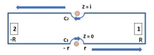

Many nice solutions are posted; let's add one more. We will get the general formula (which, in turn, can be easily transformed into Binet's second formula) by means of complex integration.
Let's denote $\,I(a)=\displaystyle \int_0^\infty\frac{\ln(1-e^{-2\pi ax})}{1+x^2}dx$, and $$J(a)=\frac{\partial}{\partial a}I(a)=2\pi\int_0^\infty\frac{x}{1+x^2}\frac{e^{-2\pi ax}}{1-e^{-2\pi ax}}dx=\pi\int_0^\infty(\coth\pi ax-1)\frac{x}{1+x^2}dx$$ Integrating by part, $$J(a)=\frac{\pi^2 a}{2}\int_0^\infty\frac{\ln(1+x^2)}{\sinh^2\pi ax}dx=\frac{\pi^2 }{2}\int_0^\infty\Big(\frac{\ln(a^2+t^2)}{2\sinh^2\pi t}-\frac{\ln a}{\sinh^2\pi t}\Big)dt$$ We introduce $r\ll1$ to make regularization: $$J(a)=\lim_{r\to0}\Big(-\pi^2\ln a\int_r^\infty\frac{dt}{\sinh^2\pi t}+\frac{\pi^2}{2}\int_r^\infty\frac{\ln(a^2+t^2)}{\sinh^2\pi t}dt\Big)\tag 1$$ Evaluation of the first integral gives $$J_{1r}=-\pi^2\ln a\int_r^\infty\frac{dt}{\sinh^2\pi t}=-\frac{\ln a}{r}+\pi\ln a+O(r)\tag 2$$ To evaluate $$J_{2r}=\frac{\pi^2}{2}\int_r^\infty\frac{\ln(a^2+t^2)}{\sinh^2\pi t}dt=\frac{\pi^2}{2}\Re\Big(\int_{-\infty}^{-r}+\int_r^\infty\frac{\ln(a-it)}{\sinh^2\pi t}dt\Big)$$ we use $\,\displaystyle\ln(a-it)=\ln\Gamma\big(a-i(t+i)\big)-\ln\Gamma\big(a-it\big)$ and $\,\displaystyle\sinh^2\pi (t+i)=\sinh^2\pi t$, and consider the integral in the complex plane along the following contour:
There are no poles inside the contour; integrals $[1]$ and $[2]$ tend to zero at $R\to\infty$.
Therefore, $$0=-\frac{\pi^2}{2}\oint\frac{\ln\Gamma(a-iz)}{\sinh^2\pi z}dz$$ $$=\frac{\pi^2}{2}\Big(\int_{-\infty}^{-r}+\int_r^\infty\frac{\ln\Gamma(a-it)}{\sinh^2\pi t}dt\Big)-\frac{\pi^2}{2}\Big(\int_{-\infty}^{-r}+\int_r^\infty\frac{\ln\Gamma(a+1-it)}{\sinh^2\pi t}dt\Big)+I_{C_1}+I_{C_2}$$ Where $I_{C_1}, I_{C_2}$ - integral along small arches around $z=0, z=i$. Taking the real part, $$J_{2r}=-\Re\,(I_{C_1}+I_{C_2})=\frac{\pi^2}{2}\Re\Big(\int_\pi^0\frac{\ln\Gamma(a-ire^{i\phi})}{\sinh^2(\pi re^{i\phi })}ire^{i\phi}d\phi+\int_{2\pi}^\pi\frac{\ln\Gamma(a+1-ire^{i\phi})}{\sinh^2(\pi re^{i\phi})}ire^{i\phi}d\phi\Big)$$ Decomposing $\ln\Gamma(z)$ near $z=a; z=a+1$ $$J_{2r}=\frac{\ln \Gamma(a)-\ln\Gamma(1+a)}{2r}\int_0^\pi (-i)e^{-i\phi}d\phi-\frac{\psi(a)}{2}\int_\pi^0d\phi-\frac{\psi(a+1)}{2}\int_{2\pi}^\pi d\phi+O(r)$$ $$J_{2r}=\frac{\ln a}{r}-\frac{\pi}{2}\big(\psi(a)+\psi(a+1)\big)+O(r)\tag 3$$ Putting $(2)$ and $(3)$ into $(1)$ $$J(a)=\lim_{r\to0}\big(J_{1r}+J_{2r}\big)=\lim_{r\to0}\Big(-\frac{\ln a}{r}+\pi\ln a+\frac{\ln a}{r}-\frac{\pi}{2}\big(\psi(a)+\psi(a+1)\big)+O(r)\Big)$$ $$J(a)=\pi\ln a-\frac{\pi}{2}\big(\psi(a)+\psi(a+1)\big)\tag 4$$ Integrating $(4)$ $$I(a)=\pi(a\ln a-a)-\frac{\pi}{2}\big(\ln\Gamma(a)+\ln\Gamma(a+1)\big)+C\tag 5$$ To identify the constant $C$, we can consider the limit $a\to 0$: $$\int_0^\infty\frac{\ln(1-e^{-2\pi ax})}{1+x^2}dx=\int_0^\infty\frac{\ln(2\pi ax)}{1+x^2}dx+O(a\ln a)=\frac{\pi}{2}\ln(2\pi a)+O(a\ln a)$$ On the other hand, from $(5)$ follows $$I(a)=\frac{\pi}{2}\ln a+C+O(a\ln a)\,\,\Rightarrow\,\,C=\frac{\pi}{2}\ln(2\pi)$$ $$\boxed{\,\,I(a)=\int_0^\infty\frac{\ln(1-e^{-2\pi ax})}{1+x^2}dx=\pi\big(a\ln a-a\big)-\pi\ln\Gamma(a+1)+\frac{\pi}{2}\ln(2\pi a)\,\,}$$

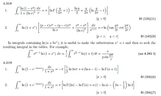

Some related integrals:
In the book "Table of Integrals, Series, and Products" (7th Edition, 2007) by I.S. Gradshteyn and I.M. Ryzhik, I found the following integrals (in Page 568, 4.318 and 4.319):
(1) For $q > 0$, we have $$\int_0^1 \frac{1}{x}\cdot \frac{\ln(1 - x^q)}{1 + \ln^2 x}\,\mathrm{d} x = \pi\left[-\ln \Gamma\left(\frac{q}{2\pi}\right) - \frac{\ln q}{2} + \frac{q}{2\pi}\left(\ln \frac{q}{2\pi} - 1\right) + \ln 2\pi\right].$$
(2) For $a > 0$, it holds that $$\int_0^\infty \frac{\ln(1 - \mathrm{e}^{-2a\pi x})}{1 + x^2}\,\mathrm{d} x = \pi \left[\frac12\ln 2a\pi + a(\ln a - 1) - \ln \Gamma(a + 1)\right].$$
Remark 1: One can prove them using @Gary's formula.
Remark 2: I think there are typos in the formulas (1) and (2) in the book (see picture below). The above formulas are the corrected. Can someone verify the formulas (typos)?
River Li
  • 49,125
  • $4.319.1$ - the overall sign is not correct (should be $,+\pi\Big[\frac{1}{2}\ln2a\pi+...\Big]$). It is easy to see that $4.319.1$ is not correct: the integral is $<0$ for all $a>0$. Leading $a\to 0$, we get $-\pi\ln a+...>0$, what is wrong. Apart from the sign, $4.319.1$ is correct.
    $,,4.319.2$ - it seems the same story takes place. At least, the sign is wrong: at $a=0$ the integral is equal to $\frac{\pi}{2}\ln2$, but 4.319.2 gives $,-\frac{\pi}{2}\ln2$
    – Svyatoslav Jul 12 '22 at 16:02
