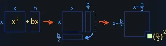

After 18 months of studying an advanced junior high school mathematics course, I'm doing a review of the previous 6 months, starting with solving difficult quadratics that are not easily factored, for example: $$x^2+6x+2=0$$ This could be processed via the quadratic equation but the course I'm working through asks me to use the complete the square method. I can do it, and I appreciate the geometric illustration of what is happening.
But it's so powerful and elegant, I can't help but wonder where else this method of adding something into an expression only to take it away in another is employed in mathematics. And is there a name for the general case of this kind of operation?
geometric complete the square
