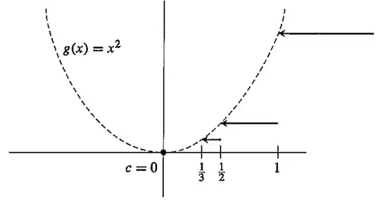

Which leaves only scenario 2., which is possible by virtue of the fact that I can come up with an example for it:
$$f(x)=\begin{cases} 0, \text{ if } x \in \left (\frac{1}{n+1},\frac{1}{n} \right ] \\ x^2, \text{ if } x \in \left (\frac{1}{n},\frac{1}{n-1} \right ] \end{cases}$$
for $n\in\mathbb{N}$.

You’re proof above is not quite incorrect, sadly. The big problem is that your example at the very end is not correct. $F’$ is continuous at $0$ in that example.

  • Why do you claim that the example I gave is incorrect? Consider the following reasoning for why $\lim\limits_{x\to 0} F'(x)$ does not exist, and tell me where it is incorrect? $f$ is discontinuous at every point $1/n$ for $n\in\mathbb{N}$ However, $f$ is continuous between $(\frac{1}{n+1}, \frac{1}{n})$ and $(\frac{1}{n},\frac{1}{n-1})$, and on these intervals by the FTC1 we have $F'(x)=f(x)$. However, at points $1/n$, $F'$ isn't defined. Thus, any interval containing $0$ has infinite points where $F'$ isn't defined. Doesn't this mean that $F'$ isn't continuous at $0$? – xoux Jul 10 '22 at 23:52
  • To be continuous at $0$ we'd need the following to be true: $\forall \epsilon>0\ \exists \delta>0\ \forall x\ |x|<\delta \implies |F'(x)-F'(0)|<\epsilon$. Maybe I am still a bit confused by the definition of continuity: the way I understand it currently, $\forall x$ includes the $x$ where $F'$ isn't defined. If it includes such $x$, then at those points we don't have $F'(x)-F'(0)|<\epsilon$ simply because $F'(x)$ doesn't exist at such points. Is this incorrect? – xoux Jul 10 '22 at 23:55

  • Okay. I guess I need to study more to get to sequences then. To summarize: within the context of the topics introduced by Chapter 13 of Spivak's Calculus, we are led to believe that $F'$ isn't continuous at $0$. Within a broader context that includes a definition of continuity in terms of sequences, we conclude that in fact, according to the more general definition, $F'$ is continuous at $0$. – xoux Jul 11 '22 at 00:36
  • Before you answer, I asked about the continuity of the function in the example in another question, for the record: https://math.stackexchange.com/questions/4490269/if-fx-0-for-x-in-1-n1-1-n-and-fx-x2-for-x-in-1-n-1-n-1-a – xoux Jul 11 '22 at 00:38
    I think that’s a fair characterization of the situation. If you want the “details” of the difference, I am looking at the domain of $F’$ as a sub metric space of the interval on which $F$ is defined. This allows us to ask about the continuity of the derivative when the function isn’t everywhere differentiable. Spivak apparently doesn’t want you to look at things that way. When I first started writing, I was thinking you were looking at a different, more advanced Spivak book. I think you should largely ignore my answer haha – Joe Jul 11 '22 at 00:41
