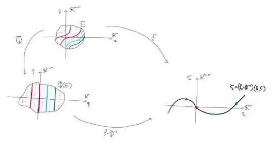

Now, the problem is to simplify the way the map $f$ looks. To do this, we introduce the map $\Phi:E\to\Bbb{R}^n=\Bbb{R}^r\times\Bbb{R}^{n-r}$ defined as $\Phi(x,y)=(f_1(x,y),y)$ (notice $\Phi(0,0)=(0,0)$). Let us calculate its derivative at the origin: from the specific structure, we have \begin{align} \Phi'(0,0)= \begin{pmatrix} \frac{\partial f_1}{\partial x}(0,0)& \frac{\partial f_1}{\partial y}(0,0)\\ 0 & I_{n-r} \end{pmatrix}= \begin{pmatrix} I_r&\frac{\partial f_1}{\partial y}(0,0)\\ 0&I_{n-r} \end{pmatrix}. \end{align} In particular, $\Phi'(0,0)$ is invertible, so by the inverse function theorem, $\Phi$ is a local diffeomorphism around the origin. I do not feel like introducing extra letters for smaller open sets, so let us just agree to replace $E$ by a smaller open set, such that $\Phi$ is a diffeomorphism of $E$ onto a product of open sets $\mathcal{E}_1\times\mathcal{E}_2$ with $\mathcal{E}_2$ connected (the reason for connectedness will be clear shortly). The simplest is to simply ensure $\Phi[E]$ is an open rectangle.
Now, observe that the map $f\circ\Phi^{-1}:\Phi(E)\to\Bbb{R}^r\times\Bbb{R}^{m-r}$ is given by \begin{align} (f\circ\Phi^{-1})(\xi,\eta)&=\bigg((f_1\circ\Phi^{-1})(\xi,\eta), (f_2\circ\Phi^{-1})(\xi,\eta)\bigg)=\bigg(\xi,(f_2\circ\Phi^{-1})(\xi,\eta)\bigg). \end{align} The last equality is because $f_1\circ\Phi^{-1}=\pi_1\circ\Phi\circ\Phi^{-1}=\pi_1$, where $\pi_1:\Bbb{R}^r\times\Bbb{R}^{n-r}\to\Bbb{R}^r$ is the standard projection. A-priori, this shows $\Phi$ has partially 'straightened out' the domain of $f$ (picture at the end).
So far, we haven't used the fact that $f$ (and hence $f\circ \Phi^{-1}$) has constant rank. We shall do so now: the derivative of $f\circ \Phi^{-1}$ has the following block structure: for all $(\xi,\eta)\in\Phi(E)$, \begin{align} (f\circ\Phi^{-1})'(\xi,\eta)&= \begin{pmatrix} I_r& 0\\ * & \frac{\partial(f_2\circ\Phi^{-1})}{\partial \eta}(\xi,\eta) \end{pmatrix}, \end{align} where $*$ is actually equal to $\frac{\partial(f_2\circ\Phi^{-1})}{\partial \xi}(\xi,\eta)$, but this is irrelevant for us. Notice that because of the identity block $I_r$ in the top left, the rank of this matrix is $\geq r$. But, by hypothesis, the rank is equal to $r$, so this can happen if and only if the bottom right block vanishes for all $(\xi,\eta)$. But then this implies $f_2\circ\Phi^{-1}$ doesn't depend on $\eta$: $(f_2\circ\Phi^{-1})(\xi,\eta)=(f_2\circ\Phi^{-1})(\xi,0)$ for all $(\xi,\eta)\in \Phi(E)$ (it is in this implication that we use connectedness (of $\mathcal{E}_2$); if a derivative vanishes identically, then locally the function doesn't on those variables, so on a connected set, we can establish this everywhere. If you want, you can shrink the open set $E$ even further so that $\Phi(E)$ is an open rectangle, and then this implication should be even more obvious).
As a result of this, we have that \begin{align} (f\circ\Phi^{-1})(\xi,\eta)&=\bigg(\xi,(f_2\circ\Phi^{-1})(\xi,0)\bigg).\tag{$\ddot{\smile}$} \end{align} Notice in particular the RHS doesn't depend on $\eta$. Now, we can truly say $\Phi$ has straightened out the domain of $f$ in the following sense:
domain straightening
So, in the picture, the image of $f$ is given by the graph of the function $\xi\mapsto (f_2\circ\Phi^{-1})(\xi,0)$. Each point on the graph has a certain preimage under $f$, which in the set $E$ is given by some squiggly curve, but if you look at the preimage under $f\circ\Phi^{-1}$, it is straight lines. So, $f\circ\Phi^{-1}$ is constant on each of these straight vertical lines.
Relating to Rudin's Statement
Hopefully now it's clear what $U,V$ are: they're just small open sets which are the domain of a certain diffeomorphism (change of coordinates). In the above presentation, I have (by slight abuse of notation) referred to them as $E$ and $\Phi(E)$. Rudin's $H$ corresponds to my $\Phi^{-1}$. The point is that $\Phi$ straightens out the domain as above. Now, in my formulation, we can write the equality $(\ddot{\smile})$ as \begin{align} (f\circ\Phi^{-1})(\xi,\eta)&=(\xi,0)+(0,(f_2\circ\Phi^{-1})(\xi,0))\tag{$**$}; \end{align} this sum is the analogue of what is in Rudin. It's just that Rudin didn't perform the reductions by affine transformations initially which is why he has to carry around the null space, range and projections everywhere in the formulas.
But hopefully the formula as stated in $(**)$ is clear geometrically: a point $(\xi,(f_2\circ\Phi^{-1})(\xi,0))$ on the graph ($F(H(x))$ in Rudin's notation) is specified by its projection $(\xi,0)$ to the Horizontal axis ($Ax$ in Rudin's notation), and its projection to the vertical axis, $(0,(f_2\circ\Phi^{-1})(\xi,0))$ which is the amount by which we have to move 'above' the base point $(\xi,0)$ (this extra sum is denoted $\phi(Ax)$ in Rudin's notation).
