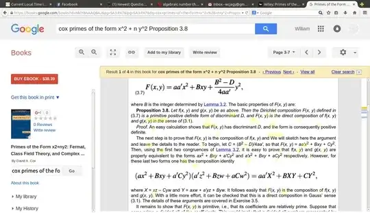

$$ (x^2 + B xy + C y^2) ( z^2 + B zw + C w^2)= m^2 + Bmn + C n^2 $$
where $$ m = xz - C yw $$ $$ n = xw + yz + Bzw $$
One may multiply values in this way for the principal form, the form that represents $1$ and has the required discriminant.
The other case is when the class number is divisible by $3$ and you have a form of order three in the class group. However, those need a bit of tinkering to get into the simple $FG = H$ format as above
Will Jagy
  • 146,052
  • Will: This is nice to have available. What is meant by the "required discriminant"? [I admit not knowing about class number.] – coffeemath Jul 02 '22 at 19:53
    @coffeemath see https://math.stackexchange.com/questions/4479936/proving-acbd2ad-bc2-a2b2c2d2-with-various-solutions/4480304#4480304 and the Cox book in general. I have the first edition, some typing errors corrected for the second. – Will Jagy Jul 02 '22 at 20:19
