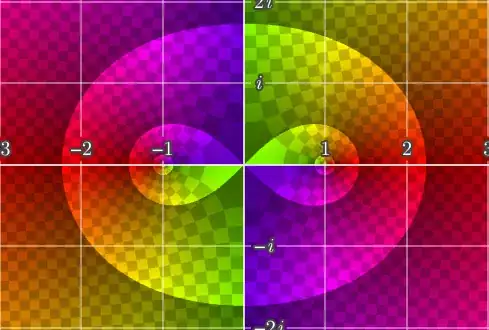

However, plotting the function suggests that a discontinuity also exists across the entire imaginary axis. (Mathematica also produces a similar plot.)
complex plot
I'm trying to understand this plot. On the positive imaginary axis, $\tau_-+\tau_+ = \pi$, giving $\arg(g) = \pi$ and $\arg(f)=\pi/2$. For points to the right of the positive imaginary axis (1st quadrant), since $\tau_-+\tau_+ < \pi$, we have $\arg(g) < \pi$ and $\arg(f) <\pi/2$. For points to the left of the positive imaginary axis (2nd quadrant), since $\tau_-+\tau_+ > \pi$, $\arg(g)$ becomes negative and close to $-\pi$, assuming the convention $-\pi < \arg(g) \leq \pi$. Now, since $g(z)$ is "fed" to the square root function to produce $f(z)$, I'm assuming that the software takes half this value to produce an $\arg(f)$ that is close to $-\pi/2$. This is what I think is causing a discontinuity in the visual representation of the function.
However, if we choose the convention $0 \leq \arg(g) < 2\pi$, or take $\arg(f)$ to be equal to $\arg(g)/2 = (\tau_-+\tau_+)/2$, without first finding the equivalent to $\arg(g)$ in the interval $(-\pi, \pi]$, the discontinuity in $\arg(f)$ (across the imaginary axis) seems to disappear.
So my question is two fold: (i) is the plotting software producing a misleading plot? (ii) isn't $f$ continuous over the imaginary axis?

    If you use the primary branch cut of $\sqrt{}$ in the form $f(z) = \sqrt{z^2+1}$, and the plotting programs probably assume that, then that function is discontinuous along the imaginary axis. The form $f(z)= \sqrt{r_{-} r_{+}} e^{i(\tau_{-}+\tau_{+})/2}$ is continuous along the imaginary axis (except the origin). – aschepler Jun 22 '22 at 13:31
Mathematica implementation of the $\arg(s)$ function has a branch cut along the negative real axis (see Sets of discontinuity) and $s=z^2-1$ is a negative real number along the entire imaginary axis since for $z=i t$ where $t\in\mathbb{R}$ then $s=z^2-1=(i t)^2-1=-t^2-1$ is always a negative real number. Therefore Mathematica's evaluation of $\arg(z^2-1)$ has a branch cut along the entire imaginary axis.
But Mathematica's evaluation of $\arg(z^2-1)$ also has a branch cut along the real axis for $z\in\mathbb{R}\land |z|<1$ since $s=z^2-1$ is also a negative real number for $z\in\mathbb{R}\land |z|<1$.
Steven Clark
