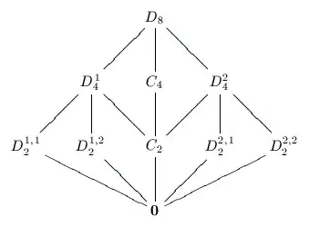

Let $G$ be a finite group, and let $L(G)$ be the lattice of subgroups, partially ordered by inclusion. For example, below is $L(D_8)$.
$\quad\qquad\quad\qquad\quad\quad\qquad$enter image description here
