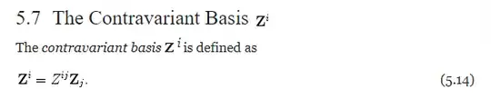

The contravariant basis $\bf Z^i$ is defined as
$${\bf Z}^i = Z^{ij}{\bf Z}_j$$
From the book:
The ${\bf Z}_j$ expression denotes the covariant basis of the tangent space at a point, aka $\partial_j,$ while $Z^{ij}=g^{ij}$ is the contravariant metric tensor.

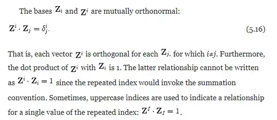

He considers the contravariant basis ${\bf Z}^{i}$ to be in $T_pM$ (my interpretation) and mutually orthogonal to ${\bf Z}_{j},$ i.e. $${\bf Z}_{j}{\bf Z}^{i}=\delta_j^i$$

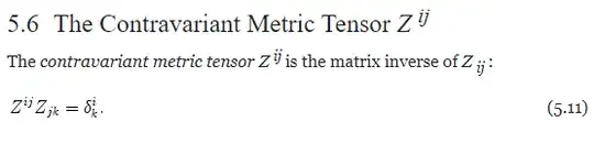

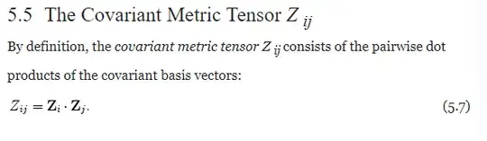

The metric tensor matrix $Z_{ij}$ is the result of the dot products ${\bf Z}_{i}\cdot {\bf Z}_j$
From the book:
and $Z^{ij}$ simply its inverse.
First question is whether it makes any sense to then decompose these basis vectors ${\bf Z}_{j}$ into any components, since it seems like they are the most basic, or primitive elements in the construct, and they are naturally linearly independent of each other. On a lecture on the metric and curvature of the sphere he derives the metric tensor very nicely from a purely spatial or geometric reasoning on the changes of the basis vectors tangential to azimuthal and polar coordinates.
If the answer, is 'no, it doesn't make sense to try and decompose these ${\bf Z}_{j}$ basis vectors into components, what is really going on in the definition of contravariant basis vectors above?
The metric tensor (or its inverse) are just scalars, so is the operation tantamount to a linear transformation of the vector ${\bf Z}_{j}$ in proportional to the dot products in the metric tensor on a given row of the metric tensor matrix? But how is this carried out on a concrete example?
    What in the world is he doing writing $Z^{ij}$ for $g^{ij}$?! This is wrong and beyond misleading. Saying mutually orthogonal is also ridiculous and wrong. These are dual basis vectors. He has a superb pedigree, so I find this alarming. The covariant basis vectors live in the dual space, so cannot be a linear combination of the contravariant basis vectors. Either you are misinterpreting or he is.making a mess of it all. – Ted Shifrin Jun 17 '22 at 03:01

    @TedShifrin yup, he calls $\frac{\partial}{\partial x^i}$ ($=\mathbf{Z}_i$) the covariant basis, and $g^{ij}\frac{\partial}{\partial x^j}$ ($=\mathbf{Z}^i$)the contravariant basis vectors, all the while remaining within the tangent space (or $\Bbb{R}^n$ in his case). Also to OP: I think I've written 2 (or maybe more) answers about similar issues recently from this text by now, so perhaps take a look at them? And regarding the question about decomposing the basis vectors: you can always write one set of basis vectors as linear combinations of others, but here I'm not sure why you would. – peek-a-boo Jun 17 '22 at 03:59

    oh, I didn't realize it was you who asked the question, nor that you awarded a bounty (thank you btw). I can definitely understand things not always being crystal clear, but this book is literally the only one I've seen that uses the metric to associate a new set of basis vectors within the tangent space, and I absolutely do not see the point of doing this. The standard math books use the metric to go back and forth between the tangent and cotangent space. Old-timey physics books talk all about raising and lowering the components of a vector/tensor, but I've never seen this before. – peek-a-boo Jun 17 '22 at 04:13

    The components of the tensor $\mathbf{Z}_j$ are tensors, not scalars / numbers /functions. Further, you need to stop referring to a "dual space" or $T_p^*$ as this is misleading and confusing. Grinfeld is using a pretty common biorthogonal system for $\mathbb{R}^n$, see https://en.wikipedia.org/wiki/Dual_basis. For example, variants of this setup is used in fluid- and material mechanics. So no forms, no manifolds, no tangent spaces.This setup is easily extended to a more "advanced" setup with minior changes to the definitions. – ContraKinta Jun 17 '22 at 12:47
