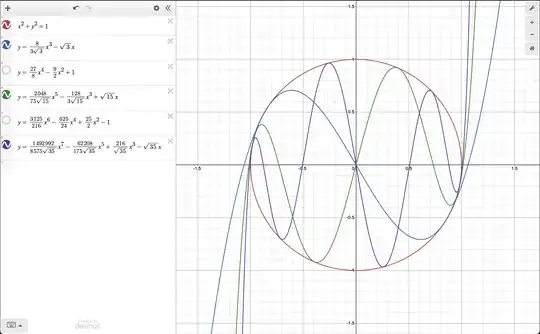

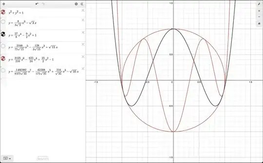

By saying circle-tangent polynomial I mean a polynomial of degree $N>2$ that lies mostly inside a unit circle except for the two tails exiting the circle and going to infinity and is tangent to the unit circle at all of its $N-1$ points of intersection with that circle, as in the graphs below:
enter image description hereenter image description here
As shown in the graph all such polynomials seem to be either odd or even functions. I can even show that a circle-tangent cubic must only be in the form $y=Ax^3+Cx$ as follows.
