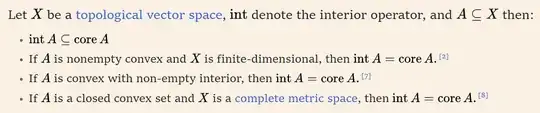

I'm trying to prove the second statement of below result, taken from this page of Wikipedia.

Theorem: Let $A$ be a convex subset of a Hausdorff t.v.s. $X$. If $\dim A < +\infty$ then $\operatorname{aint} (A) = \operatorname{int} (A)$.
Lemma 1: Let $V$ be a $n$-dimensional Hausdorff t.v.s. and $A:=\{x_1, \ldots, x_{n+1}\} \subset V$ affinely independent. Then $\operatorname{int} (\operatorname{conv} A) \neq \emptyset$.
Lemma 2: Let $A$ be a convex subset of a t.v.s. $X$. If $\operatorname{int} (A) \neq \emptyset$, then $\operatorname{aint} (A) = \operatorname{int} (A)$.
