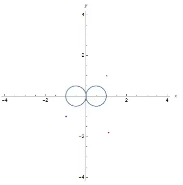

The following code makes plot of multiplication of two points:
p1 := {1, 1}
p2 := {-1, -1}
p := Multiply[p1, p2] // N
ContourPlot[(x^2 + y^2)^2 == x^2, {x, -4, 4}, {y, -4, 4},
 Axes -> True, AxesLabel -> Automatic, Frame -> None,
 Epilog -> {Gray, Point[p1], Blue, Point[p2]}, Red, Point[p]]
That said, I wonder, what algebraic and analytic properties this system has? It seems to be a 2-dimensional hypercomplex commutative numbering system that is not isomorphic to complex, split-complex and dual numbers.
One interesting feature of this system is existence of divisors of infinity because $(0,1)(0,1)=\infty$ (multiplication by divisors of infinity cannot be handled by the provided code though). This makes the system not closed under multiplication unless an improper element $\infty$ is attached. On the other hand, the system has no zero divisors. The system is not distributive, though, despite being commutative and associative.
