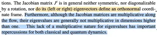

What is the meaning of the (blue) text, which looks important?
f2
