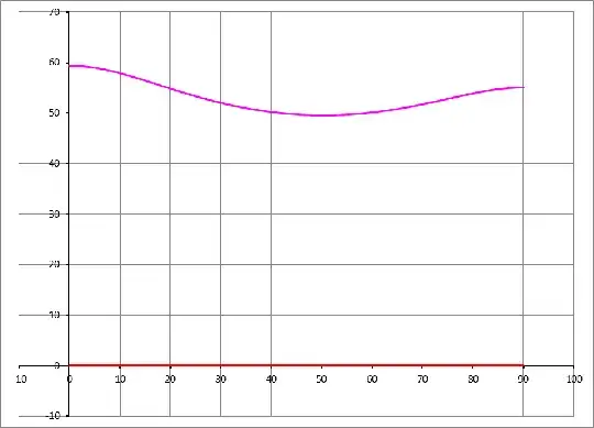

As an example, I let $a = 3, b = 5, c = 4$, and plotted the resulting $\theta$ as a function of $\phi$ for an eccentricity of $ e = 0.7 $ over the range $0^\circ \le \phi \le 90^\circ$.
