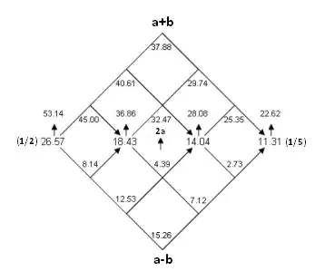

Consider trivial trig identity: $$\tag 1\tan(a+b) = \frac {\tan a + \tan b}{1-\tan a\tan b} $$ Now substitute: $$\tan a = N_1/D_1$$ $$\tan b = N_2/D_2$$ So 1 becomes: $$\tag 2\tan(a+b) =\frac {N_1D_2+N_2D_1}{D_1D_2-N_1N_2}$$ $$\tag 3\tan(a-b) =\frac {N_1D_2-N_2D_1}{D_1D_2+N_1N_2}$$ And use this "magic hash table": $$\tan 26.57^\circ = 1/2$$ $$\tan 18.43^\circ = 1/3$$ $$\tan 14.04^\circ = 1/4$$ $$\tan 11.31^\circ = 1/5$$
And a following useful identities for small angels in radians $$\tan a = a, |a| <0.05 (3.0 ^\circ) $$ And for angles more than $45^\circ$ $$\tan a = 1/\tan(90°−a)$$
You can also recursively repeat this process to get more and more precious approximation then:
$$a_i=a_{i-1}\pm b_{i-1}$$
$$\tag 4 \tan b_i=b_i=x - a_i$$
Where $a_0$ and $b_0$ picked from the table and $x$ is initial angle value
While evaluating $(4)$ you need conversion to radians. It is simply multiplication on $7/400$ So you need to aproximate $x-a_i$ with such fraction what it has $7$ in denominator and/or dividers of $400$ in numerator.
Google for "Fast_Approximation_of_Elementary_Functions.pdf" paper for further information on this trick. Direct link is prohibitted for some strange reason.
P.S. Drawing for using instead of remebering the hash table and for fast picking of $a_0$ $b_0$: enter image description here
P.P.S. To remember $(2)$ consider product of two complex numbers $$z=(D1,N1)(D2,N2)$$ so $(2)$ becomes:
$$\frac {\Im z}{\Re z}$$ to get $(3)$ just swap signs

  • Great, I've seen that paper before been at that time I was learning how to approximate exponentials so I disregarded the tangent, and subsequently couldn't remember the name of the paper. Anyway, this does look like a very good method, but it will definitely take some time to get a knack for it and memorize the "magic hash table" =) – brianmearns Jul 18 '13 at 10:52
  • Do not remember anything and do not calculate first round of approximation just use the picture from papper i added. – igumnov Jul 18 '13 at 11:18

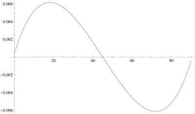

This may not be the best for in-your-head calculation, but for $x$ in degrees $$ \tan\left(\frac{\pi x}{180}\right)\approx\frac{x(990-4x)}{(90-x)(630+4x)}\tag{1} $$ is at most $0.6\%$ off for $0\le x\le90$.
Here is a plot of the relative error:$\displaystyle\left.\frac{x(990-4x)}{(90-x)(630+4x)}\middle/\tan\left(\frac{\pi x}{180}\right)-1\right.$ :
$\hspace{2cm}$enter image description here
Equation $(1)$ looks a little daunting, but at least $x$ is in degrees, and the relative error is quite small. Really, the only constant that needs to be remembered for $(1)$ is $\frac{990}{4}$; that is, $$ P(x)=x\left(\frac{990}{4}-x\right)\implies\tan\left(\frac{\pi x}{180}\right)\approx\frac{P(x)}{P(90-x)}\tag{2} $$

  • Wow, that's a pretty remarkable error, but you're right, that would be a bit much for mental math, primarily because there are so many different values to keep track of. I wonder if it can be simplified any more, allowing for more generous error bounds. – brianmearns Jul 18 '13 at 10:55
    @sh1ftst0rm: If we recall that $\tan(90^\circ-x)\tan(x)=1$, we only need to remember $\frac{990}{4}$.
    Let $P(x)=x\left(\frac{990}{4}-x\right)$, then $$ \begin{align} \tan\left(\frac{\pi x}{180}\right) &=\frac{P(x)}{P(90-x)}\ &=\frac{x\left(\frac{990}{4}-x\right)}{(90-x)\left(\frac{630}{4}+x\right)} \end{align} $$ Still the numerator and denominator are quadratics.

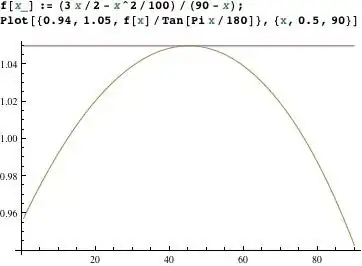

The function $$f(x):={{3\over2}x-{1\over100}x^2\over 90-x}$$ produces a relative error which is less than $6\%$ over the whole range $[0,{\pi\over2}[\ $. See the following figure:
