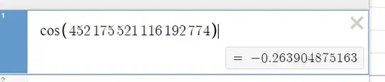

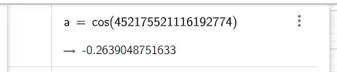

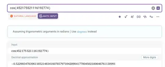

I want to calculate cosine of 452175521116192774 radians (it is around $4.52\cdot10^{17}$)
Here is what different calculators say:
Wolframalpha WolframAlpha
Desmos
Desmos
Geogebra
Geogebra
Python 3.9 (standard math module)
Python
Python 3.9 (mpmath library)
Python3
Obviously there is only one solution. There could be errors in floating point precision for these calculators, but this stumbles me. My calculator (TI-30XIS) says domain error (which is weird because cosine of, for example, a billion works just fine). How can I get the cosine of very large integers?

  • I trust WolframAlpha the most, but it even gives the message that it assumes radians instead of degrees. See: https://www.wolframalpha.com/input?i=cos%5C%2840%29452175521116192774%5C%2841%29&assumption=%22TrigRD%22+-%3E+%22R%22 – musava_ribica May 28 '22 at 17:03
  • What is even weirder about this is that if you scroll down in WolframAlpha, it says $\cos(452175521116192774) \approx -0.263905$. If you input $\cos(452175521116192774 \bmod 2\pi)$ though, you get $\approx -0.5229$ which I think is the true value. –  May 28 '22 at 17:37
  • @DietrichBurde Pretty sure WA means radians. – lulu May 28 '22 at 17:54
  • Pari gives $-0.52290347839611852148341607857971042099$, like WA. – Dietrich Burde May 28 '22 at 17:57

The problem is that your integer $$n=452175521116192774$$ can't be stored exactly as a standard 64-bit IEEE double precision floating point number. The closest double happens to be $$x=452175521116192768,$$ as can be seen from the binary representation $$ \begin{aligned} n &= 11001000110011100110011110110100000010000100000000000\color{red}{000110}_2 \\ x &= 11001000110011100110011110110100000010000100000000000\color{red}{000000}_2 \end{aligned} $$ where those last few bits in $n$ are lost, since the double format only stores the first 52 digits after the leading “1”.
So in systems that use standard floating point (like Desmos, Geogebra, and the Python math module) you will actually get $x$ when you enter $n$ in a place where a double is expected; in Python you can verify this as follows:
> print("%.310g" % 452175521116192774)
452175521116192768
Conseqently, when you ask for $\cos n$ these systems will answer with $$\cos x = -0.2639 \ldots$$ (which in itself is computed correctly; it's just that the input is not what you thought).
In contrast, Wolfram Alpha and mpmath work with the exact number $n$, and give the correct answer $$\cos n = -0.5229 \ldots$$
