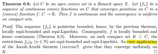

I'm reading Theorem 0.9 in this lecture note. enter image description here
Below is my attempt where I got stuck at the end. Could you elaborate on how to finish the proof?

  • Clearly, $f$ is convex. Convergent sequence is bounded, so $(f_n)$ is pointwise bounded. By Lemma 1, $(f_n)$ is locally equi-Lipschitz and locally equi-bounded. Fix $a\in C$. There is a neighborhood $U$ (in the subspace topology of $C$) of $a$ and $m \in \mathbb R$ such that $$ |f_n(x)| \le m \quad \forall n \in \mathbb N, \forall x\in U. $$ It follows that $|f(x)| \le m$ for all $x \in U$. Hence $f$ is locally bounded. Then by Lemma 2, $f$ is continuous.
  • Fix a compact subset $K \subset C$. Let $g_n := f_n \restriction K$ and $g := f \restriction K$. Then $(g_n)$ is pointwise bounded and pointwise equi-continuous. By Arzelà–Ascoli theorem, there exist $h \in C(K)$ and a subsequence $\varphi \in \mathbb N^\mathbb N$ such that $g_{\varphi(n)} \to h$ in $\| \cdot \|_\infty$. This implies $g_{\varphi(n)} \to h$ pointwise and thus $h=g$. Hence $g_{\varphi(n)} \to g$ in $\| \cdot\|_\infty$.
However, I'm stuck at showing $g_{n} \to g$ in $\| \cdot\|_\infty$.

    We have $(g_n)$ is locally equi-Lipschitz on $K$. Could you elaborate on how you get $(g_n)$ is equi-Lipschitz on $K$? – Akira May 24 '22 at 21:37
  • I was worried about the same thing but if we read carefully, we are told the restrictions are equi-Lipschitz on $K$. – M A Pelto May 24 '22 at 21:38
  • I'm worried that we can not prove it :v – Akira May 24 '22 at 21:39
  • Me too, but the author of this paper doesn't seem too worried. If it is any consolation, it isn't too difficult to prove that $g$ is Lipschitz on $K$ given that it is the uniform limit of a sequence that is equi-Lipschitz on $K$. – M A Pelto May 24 '22 at 21:48
  • see edit and let me know if you want me to worry about showing $\mathcal{G}$ is locally equi-Lipschitz on $K$. :) – M A Pelto May 24 '22 at 22:11
  • Nvm to the latter proposition in my preceding comment, I see the notes have already covered showing as much. – M A Pelto May 24 '22 at 22:58
    If $y,z \in U_{x_i}$ for some $i$, then we certainly have $|f(y)-f(z)| \le L|y-z|$. How about the case where $y,z$ don't belong to the same neighborhood? – Akira May 25 '22 at 08:07
    Please see my update. – Akira May 25 '22 at 09:51
  • Fixed. Sorry, it took so long--I was busy. – M A Pelto Jun 02 '22 at 08:11
