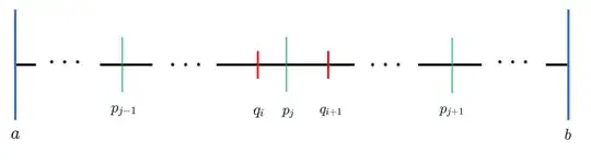

The following picture will be useful to understanding the argument:
use pic
The next question to consider is: "How small should we make these subintervals when constructing our uniform partition?"
There are two scenarios to consider:
  1. The new small subinterval from the uniform partition is contained purely within (end-point overlap allowed) a subinterval of $P \in \mathcal T$. Letting the $P$ subinterval be denoted by $[p_{j-1},p_j]$, it should be clear that new small subinterval contained within $[p_{j-1},p_j]$ has its own infimum $\geq$ the full-interval infimum on $[p_{j-1},p_j]$. Therefore, we do not need to consider these in order to prove $\dagger_1$ (as such conditions would be truthful for any $\varepsilon \gt 0$).

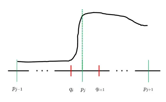

  2. The new small subinterval from the uniform partition spans two consecutive subintervals from $P$ (like that depicted in the above image). For this scenario, (referencing the symbols used in the above image), it is NOT necessarily the case that the infimum of $[q_{i-1},q_i]$ is simultaneously $\geq$ the infimum of $[p_{i-1},p_i]$ and $[p_{i},p_{i+1}]$ (the counter example shown by Nico Tripeny in his one answer demonstrates this nicely). Just to make sure the idea is conveyed, consider the below image:
Picture 2
Although the infimum of the proposed function on $[q_{i-1},q_i]$ is $\geq$ the infimum on $[p_{i-1},p_i]$, it is clearly NOT the case for $[p_{i}, p_{i+1}]$. As such, we actually have that the infimum of $f$ on $[q_{i-1},q_i]$ is $\lt $ the infimum of $f$ on $[p_{i},p_{i+1}]$, and we need to properly account for this in order to prove $\dagger_1$. Technically, depending on the shape of $f$, it could be the case that $m_{q_{i+1},q_i} \gt m_{p_{j},p_{j-1}}$ and $m_{q_{i+1},q_i} \gt m_{p_{j+1},p_{j}}$...but, in such a circumstance, no special treatment is needed (for the same reason as case 1). So let us suppose that we are only dealing with 'bad' versions of case 2.
For this second case, recall our definition of lower sums. It is easy to see that for a given $i^{\text{th}}$ subinterval, we can rewrite the contributing sum from $m_i\cdot(t_i-t_{i-1})$ to $m_i\cdot (z-t_{i-1})+m_i\cdot(t_i-z)$ for some $z \in [t_{i-1},t_i]$.
With this in mind and referencing our above photo, consider the contributions that the following partial intervals make to the lower sums of $L(f,P)$ and $L(f,P')$, respectively:
$$(p_j-q_i)\cdot m_{p_j,p_{j-1}}+(q_{i+1}-p_j)\cdot m_{p_{j+1},p_j}$$
and
$$(p_j-q_i)\cdot m_{q_{i+1},q_i}+(q_{i+1}-p_j)\cdot m_{q_{i+1},q_i}$$
Because we assume that $f$ is bounded (meaning $\forall x: |f(x)|\lt N$...and let $M=N+1$), we certainly know that the following must be true:
\begin{align}&\left|\left[(p_j-q_i)\cdot m_{p_j,p_{j-1}}+(q_{i+1}-p_j)\cdot m_{p_{j+1},p_j}\right]-\left[(p_j-q_i)\cdot m_{q_{i+1},q_i}+(q_{i+1}-p_j)\cdot m_{q_{i+1},q_i}\right] \right| =\\ & \left| \left[(p_j-q_i)\cdot m_{p_j,p_{j-1}}-(p_j-q_i)\cdot m_{q_{i+1},q_i}\right] + \left[(q_{i+1}-p_j)\cdot m_{p_{j+1},p_j}-(q_{i+1}-p_j)\cdot m_{q_{i+1},q_i}\right] \right| \leq \\ &\left|(p_j-q_i)\cdot m_{p_j,p_{j-1}}-(p_j-q_i)\cdot m_{q_{i+1},q_i}\right|+\left|(q_{i+1}-p_j)\cdot m_{p_{j+1},p_j}-(q_{i+1}-p_j)\cdot m_{q_{i+1},q_i}\right| \lt \\ &(p_j-q_i)2M+(q_{i+1}-p_j)2M=\left(q_{i+1}-q_{i}\right)2M=\frac{b-a}{k}2M\end{align}
We thus have that:
$$\left|\left[(p_j-q_i)\cdot m_{p_j,p_{j-1}}+(q_{i+1}-p_j)\cdot m_{p_{j+1},p_j}\right]-\left[(p_j-q_i)\cdot m_{q_{i+1},q_i}+(q_{i+1}-p_j)\cdot m_{q_{i+1},q_i}\right] \right|\lt \frac{b-a}{k}2M$$...and, really, the absolute bars can be dropped because we are only dealing with the 'bad' version of case 2.
Because the partition $P$ is comprised of $n$ subintervals, the bad version of case 2 can occur at most at $n-1$ locations. Therefore, if we tally up all of these accumulated differences, we will have a difference of $\lt (n-1)\times \frac{b-a}{k}2M$.
We previously required that $\frac{1}{k} \lt \frac{d}{b-a} \quad (*_1)$. However, there is nothing from preventing us from constructing a number that is even smaller...in fact, we can make an arbitrarily small number. Therefore, let us also impose that $\frac{1}{k}\lt \frac{\varepsilon}{2M\times (n-1)\times(b-a)} \quad (*_2)$. Choose the $k$ that satisfies both $(*_1)$ and $(*_2)$. Under such circumstances, we then have that $(n-1)\times \frac{b-a}{k}2M \lt \varepsilon$.
Finally, suppose that we construct a uniform partition $P' \in \mathcal S$ that has $k$ subintervals of equal length (where $k$ adheres to our aforementioned criteria). Let $K_1$ be a collection of the various subintervals that are created from the members of $P'$ that specifically correspond to case 1; let $K_2$ be a collection of the various subintervals that are created from members of $P'$ that specifically correspond to case 2. Note that $K_1 \cup K_2$ contains all subintervals that comprise $P'$. Next, let $x_1$ be the partial lower sum contribution to the total lower sum of $P$ (not $P'$), derived from the subintervals of $K_1$. For example, in the earlier displayed graphic, if $q_{i-1}$ was also contained within the $[p_{j-1}, p_{j}]$ subinterval of $P$, then $m_{p_{j}, p_{j-1}}\times (q_i-q_{i-1})=m_{p_{j}, p_{j-1}}k$ would represent just one of the participants to this collective $x_1$ term.
In a similar fashion, let $x_2$ correspond to the partial lower sum contribution to the total lower sum of $P$, derived from the intervals of $K_2$. Referencing the above graphic, an example of one term included in this collective $x_2$ summation would be: $(p_j-q_i)\cdot m_{p_j,p_{j-1}}+(q_{i+1}-p_j)\cdot m_{p_{j+1},p_j}$. It should be obvious that $x_1+x_2=x$, where $x$ is the total lower sum of $P \in \mathcal T$. Let us define $y_1$ and $y_2$ similarly, but in the context of $P'$ (i.e. the infimums of the subintervals are defined relative to the $q$'s, not the $p$'s). Clearly, $y_1+y_2=y$, where $y$ is the total lower sum of $P' \in \mathcal S$.
Consider the expression $(x_1-y_1)+(x_2-y_2)$, which will be a useful way of denoting $(x_1+x_2)-(y_1+y_2)$. We want to show that this expression can be made arbitrarily small (or just negative) depending on our selection of $k$ (i.e. depending on your construction of $P'$). By construction, we know that $(x_2-y_2) \lt \varepsilon$. But we also know that $(x_1-y_1) \leq 0$. Therefore, $(x_1-y_1)+(x_2-y_2)\lt \varepsilon \iff (x_1+x_2) \lt y_1+y_2 +\varepsilon \iff x \lt y +\varepsilon$.
