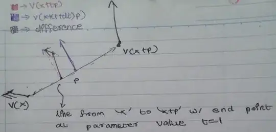

What I think the integral means is - compute the integral element-wise for each entry in the $nx1$ column vector that results from left-multiplying the Hessian of $f$ at $(\overrightarrow x + t\overrightarrow p)$ by $\overrightarrow p$. Is this correct?
Moreover, how is this derived as a consequence from Taylor's Theorem? I have not been able to figure out how to make that jump and was struggling with the notation of integrating over a vector in this manner.
