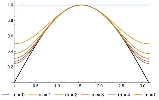

Old Question. While working to find a good upper bound of $\left|\sin x\right|$, I experimentally observed that
$$ \left|\sin x\right| \leq \bbox[color:navy]{ \frac{(2m+1)!}{2^{4m}(m!)^2} \biggl[ \binom{2m}{m} - \sum_{k=1}^{m} \frac{2}{4k^2-1} \binom{2m}{m+k} \cos(2kx) \biggr] } =: S_m(x) \tag{*} $$
holds for all $x \in \mathbb{R}$. However, I have no idea how to prove this, and a quick search on Approach Zero but it did not show anything. So, I am sharing my question with other users:
Question. Does the inequality $\text{(*)}$ really hold true? If so, how can we prove this?
Anyway, here are several observations:
  1. For each $m$, $S_m(x)$ seems to be the unique trigonometric polynomial $\sum_{k=0}^{m} a_k \cos(2kx)$ satisfying $$ \sum_{k=0}^{m} a_k \cos(2kx) = \sin(x) + o\bigl(x-\tfrac{\pi}{2}\bigr)^{2m}. $$ This is actually how I conjectured the coefficients of $S_m(x)$. For each $m$, I determinted the values of $a_k$'s and tried to identify the patterns using OEIS. So, unfortunately I don't have a slightest idea as to how the coefficients of $S_m(x)$ arise.
  2. By noting that $\frac{(2m+1)!}{2^{4m}(m!)^2}\binom{2m}{m+k} \to \frac{2}{\pi}$ as $m \to \infty$, we get $$ \lim_{m\to\infty} S_m(x) = \frac{2}{\pi} \biggl[ 1 - \sum_{k=1}^{\infty} \frac{2}{4k^2-1} \cos(2kx) \biggr]. $$ This is precisely the Fourier cosine series for $\left|\sin x\right|$. So, $\text{(*)}$ is consistent with the Fourier series for $\left|\sin x\right|$.
  3. Surprisingly, $S_m(x)$ seems to be unimodal on $[0, \pi]$ (and hence on each $[k\pi, (k+1)\pi]$ for $k \in \mathbb{Z}$), as we can see from the figure below: graph

  • I would try to prove it's decreasing in $m$ – Exodd May 11 '22 at 09:56
  • @Exodd, That might be one proof strategy, but I believe that we need another representation of $S_m(x)$ that allows certain monotonicity in $m$ to be discovered. The current form of $S_m(x)$ seems not adequate for that purpose. – Sangchul Lee May 11 '22 at 13:17
Writing down $S_{m-1}(x) - S_{m}(x) \ge 0$ you end up with the equivalent conditions $$\binom{2m}{m} + 2\sum_{k=1}^m \binom{2m}{m+k}\cos(2kx)\ge 0$$ or equivalently $$ \sum_{k=-m}^m \binom{2m}{m+k}\exp(2\text ikx)\ge 0 $$ but the LHS is just $[2\cos(x)]^{2m}$ that is always nonnegative.
I think you can then characterize $S_m(x)$ recursively as $$ S_{m+1}(x) = S_{m}(x) - \frac{2(2m)! }{2^{4m}(m!)^2(2m+3)} [2\cos(x)]^{2m+2} $$
Exodd
  • 12,241
  • 27
  • 44
  • That is indeed a crucial hint! Motivated from this, I can now recognize $S_m(x)$ as simply $$ S_m(x) = T_{2m}(\cos x), $$ where $T_{2m}$ is the degree $2m$ Taylor polynomial of $\sqrt{1-x^2}$. The monotonicity then follows from the fact that all the coefficients of the Maclaurin series of $\sqrt{1-x^2}$, except for the constant term, are negative. I will update my posting accordingly. – Sangchul Lee May 12 '22 at 09:46

Sangchul Lee
  • 181,930
$$S_m(x)=\frac{2\, \Gamma \left(m+\frac{1}{2}\right) \Gamma \left(m+\frac{3}{2}\right)}{\pi\, \Gamma(m+1)^2}-\frac{2 m (m+1) \Gamma \left(m+\frac{1}{2}\right) \Gamma \left(m+\frac{3}{2}\right)}{3 \pi \Gamma (m+2)^2}\,T_m(x)$$
$$T_m(x)=e^{-2 i x} \, _3F_2\left(\frac{1}{2},1,1-m;\frac{5}{2},m+2;-e^{-2 i x}\right)+$$ $$e^{2 i x} \, _3F_2\left(\frac{1}{2},1,1-m;\frac{5}{2},m+2;-e^{2 i x}\right)$$
Beside the fact that $S_m\left(\frac{\pi }{2}\right)=0$, for $0\leq x \leq \pi$ (explored by steps of $\frac \pi {180}$) and $1 \leq m \leq 10^4$, $\left(S_m(x)-\sin(x)\right)$ is a fast decreasing function which is always positive. For sure, the largest difference is at the boundaries.
$$S_m(0)=\frac{\Gamma \left(m+\frac{1}{2}\right)}{\sqrt{\pi }\, \Gamma (m+1)}$$
Expanded as series around $x=\frac \pi 2$ $$S_m(x)-\sin(x)=\frac {a_m}{b_m} \left(x-\frac{\pi }{2}\right)^{2 (m+1)}+O\left(\left(x-\frac{\pi }{2}\right)^{2(m+2)}\right)$$ where the $a_m$ are sequence $A098597$ and the $b_m$ are sequence $A046161$ in $OEIS$. All of them are positive and, as a very first approximation $$\frac {a_m}{b_m} \sim \frac 1{2m^2}$$
  • Thank you! I haven't thought about investigating the extra terms of the Taylor series $S_m(x)-\sin(x)$, so it's nice to see that they also have nice patterns. This and other observations together seem strongly hinting a combinatorial origin that I am currently not aware of. – Sangchul Lee May 12 '22 at 09:02
  • @SangchulLee. You are more than welcome ! For once, I bring something to you ! This is a big event. I shall cotinue. Cheers -:) – Claude Leibovici May 12 '22 at 09:07
  • Motivated from Exodd's answer, I realized that $S_m(x)$ is simply $$ S_m(x) = T_{2m}(\cos x), $$ where $T_{2m}$ is the degree $2m$ Taylor polynomial of $\sqrt{1-x^2}$. So there is not much secret in the inequality I found, but at least It was a fun question! – Sangchul Lee May 12 '22 at 09:48
  • @SangchulLee. It was a very interesting problem. Thanks for having posted it. Cheers :-) – Claude Leibovici May 12 '22 at 12:03
