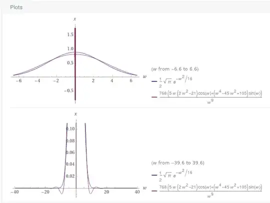

I am going to graph it against the Fourier Transform of $g(t)$, which under the same definition of the transform is going to be: $$\hat{g}(w) = \frac{\sqrt{\pi}}{2}e^{-\frac{w^2}{16}}\tag{Eq. 5}\label{Eq. 5}$$
Comparison of the Fourier Transforms

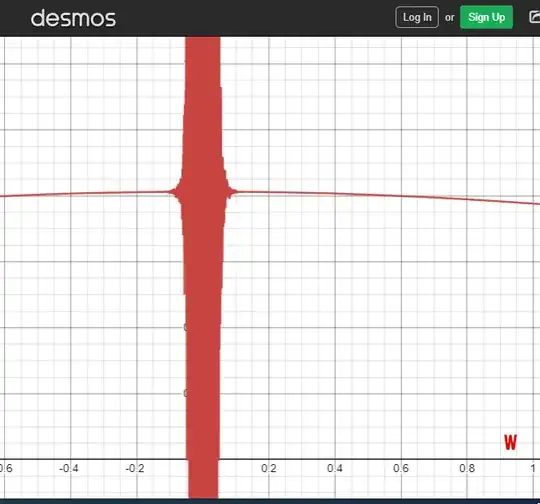

They look similar, but something "weird" is happening near the DC component $w \approx 0$ for the solution $\hat{f}(w)$ of \eqref{Eq. 4}.
To have a better insight I plot $\hat{f}(w)$ also in Desmos and there exist an "horrible noise-like rippling" that also "looks" to be diverging as a singularity!
Horrible Rippling

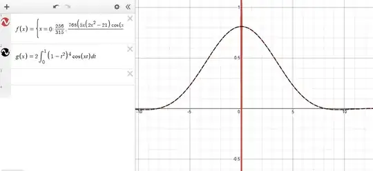

I have noted now another interesting thing:
Integrating $\hat{f}$ as is shown here, and integrating $\hat{g}$ as is shown here gives the same result: $$\int\limits_{-\infty}^{\infty}\hat{f}(w)\,dw = \int\limits_{-\infty}^{\infty}\hat{g}(w)\,dw = 2\pi$$

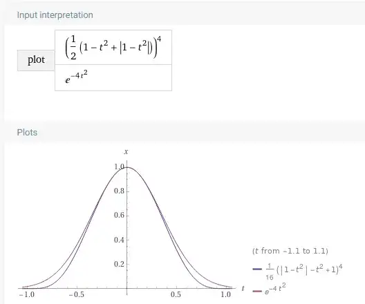

I have tried another slightly different approximation: $$q(t) = \left(\frac{1-t^2+|1-t^2|}{2}\right)^{\pi} \tag{Eq. 6}\label{Eq. 6}$$

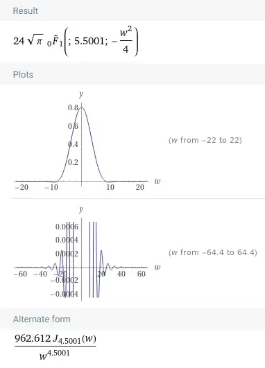

So obviously again the numerical issues arises, but for a "good" approximation I am using on Wolfram-Alpha: $$\hat{f}^*(w) = \sqrt{\pi}\,\Gamma(1+4)_0\tilde{F}_1\left(;\,\frac{3}{2}+4.0001;\,-\frac{w^2}{4}\right) \tag{Eq. 9}\label{Eq. 9}$$
and suddenly the problem is gone... it is kind of ridiculous that "just" for the exact numbers the problem happen.
Approximated version

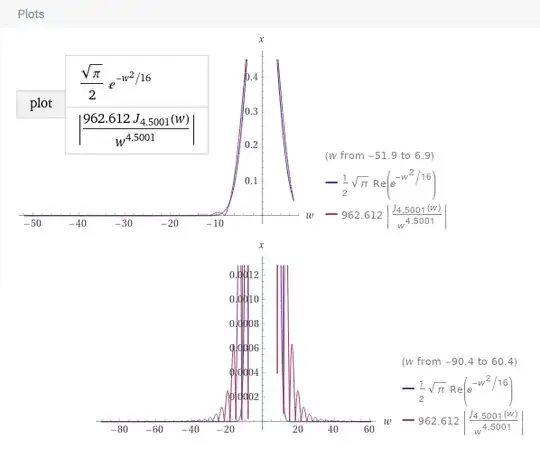

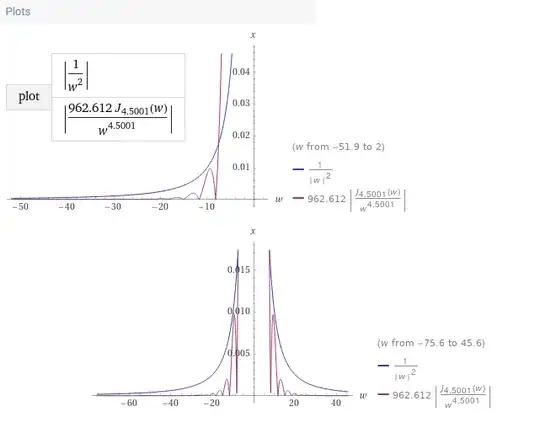

But nevertheless, the tails are decreasing faster than $|\frac{1}{w^2}|$ so I don´t know why the result is not finite (see here).
Tails comparison
As example, if I used the other aporoximarion: $$\hat{f}^*(w) \approx \frac{962.612\,J_{4.5001}(w)}{w^{4.5001}}\tag{Eq. 11}\label{Eq. 11}$$ Wolfram-Alpha is unable to find $\|\hat{f}^*(w)\|_1$, but it is possible to bound it as: $$\|\hat{f}^*(w)\|_1 < \underbrace{\int\limits_{-10}^{10}\left|\frac{962.612\,J_{4.5001}(w)}{w^{4.5001}}\right|\,dw}_{6.34416}+\underbrace{\int\limits_{10}^{\infty}\left|\frac{2}{|w^{2}|}\right|\,dw}_{0.2} <\infty$$ as can be seen here and here. And since the difference with the approximation and the main function with numerical issues is in the bounded domain $[-1,\,1]$, it should also be bounded, so the norm $\|\hat{f}(w)\|_1<\infty$ but somehow Wolfram-Alpha can't find it.

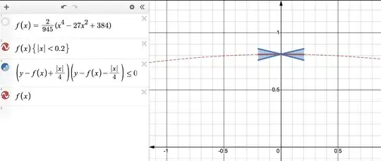

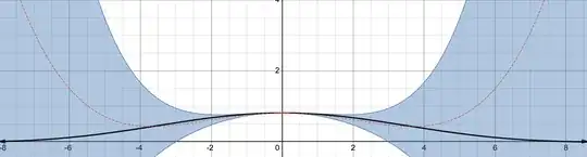

Note that in the formula $$ \mathcal Ff(w)=\frac{768 \Big(5w\,(2 w^2-21)\cos(w)+(w^4-45w^2+105) \sin(w)\Big)}{w^9},$$ if we want to see that the numerator is $O(w^9)$, we should (unless we are super lucky) use at least a 8th order Taylor expansion around 0 for the cosine on top, and a 9th order expansion for the sine. This is because of the low order terms in the polynomial coefficients ($-21$ and $+105$, respectively.)
Denote the $n$th partial Taylor expansion around $x_0$ of $f$ at $x$ by $$ T^n f(x_0;x) = \sum_{k=0}^n \frac{f^{(k)}(x_0)}{k!}(x-x_0)^n.$$ Since all derivatives of sine and cosine are uniformly bounded by 1, Taylor's theorem gives, $$ |\cos(w) - T^8 \cos(0;w)| \le \frac{w^9}{9!}, $$ and similarly $$ |\sin(w) - T^9 \sin(0;w)| \le \frac{w^{10}}{10!} ,$$ If we just replace $\cos(w)$ with $T^8 \cos(0;w)$ and $\sin(w)$ with $T^9 \sin(0;w)$ to get $$\tilde f(w):=\frac2{945} (w^4 - 27 w^2 + 384),$$ we incur an error of size at most $$ \frac{768 \Big(5|w|\,(2 w^2\color{red}+21)|w|^9/9! +(w^4\color{red}+45w^2+105) w^{10}/10!\Big)}{|w|^9} = \frac{|w| (1155 + 145 w^2 + w^4)}{4725}. $$ For say $|w|<0.2$, this error is at most $$\frac{1160.8016|w|}{4725}<\frac {|w|}4<\frac1{20}.$$ Therefore, $\mathcal Ff$ stays in the shaded blue region below. The approximation $\tilde f$ is plotted in red. (Desmos link) enter image description here Of course, using more terms will give a more impressive bound, but this is enough to rule out the spiky behavior you saw.

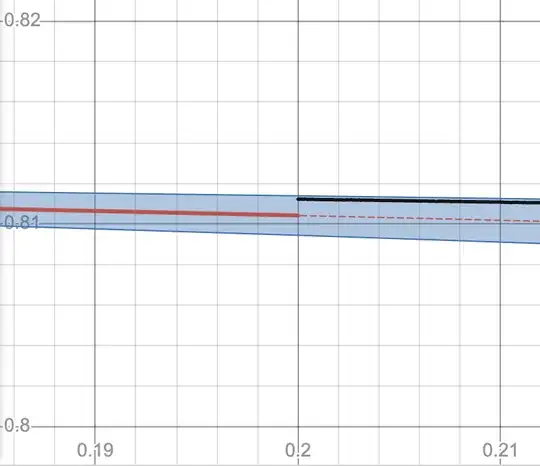

In fact, in the current situation there is extra cancellation, since $T^8 \cos(0;w)=T^9 \cos(0;w)$ and $T^9 \sin(0;w)=T^{10} \sin(0;w)$, giving us a much better error estimate. Redoing the above calculations shows that the error is no more than $(w^2 (w^4 + 155 w^2 + 1260))/51975$ which is $\le w^2/30$ for $w\le 1$. This explains why the approximation is a much better match than the above error plot suggests. The true function $\mathcal Fg$ is plotted in black (for $|x|>0.2$) below: (desmos link)
You have to zoom in quite far in order to even notice that they don't exactly match at $x=0.2$: enter image description here

Your $\hat f$ is correct. The graphing programs are not able to give accurate graphs of that $\hat f$ function near $x=0$, at least not from that formula.
The most common form of representing real numbers in computer languages is floating-point arithmetic, where a possible value is an integer times a power of two. The double type lets the integer part use up to 52 bits, so relative errors from operations like multiplication tend to be a few times $2^{-52}$ in magnitude relative to the value. But when addition or subtraction should result in a number much closer to zero, many of the higher-order bits cancel out, and a small proportion of the value bits could be accurate.
In the formula
$$ \hat{f}(w) = \frac{768 \Big(5w\,(2 w^2-21)\cos(w)+(w^4-45w^2+105) \sin(w)\Big)}{w^9} $$
when $w$ is near zero, the addition in the numerator adds a number approximately equal to $-105w$ and a number approximately equal to $105w$, and we expect to get a number approximately equal to $w^9/945$, much much closer to zero. So since plotting programs probably use these double values to be able to get many function values in a reasonable time, they'll be inaccurate when trying to get values near zero.
We can see similar errors asking Wolfram to plot
$$ g(x) = \left(\sin x - x + \frac{x^3}{6} - \frac{x^5}{120}\right)\frac{7!}{x^7} $$
If I convert your $\hat f$ to its Taylor expansion
$$ \hat{f}(w) = 768 \sum_{k=0}^\infty \left( \frac{1}{(2k+1)!} - \frac{10}{(2k+2)!} + \frac{45}{(2k+3)!} - \frac{105}{(2k+4)!} + \frac{105}{(2k+5)!} \right) (-1)^k w^{2k-4} $$
Wolfram still gets the same bumpy graph, possibly by doing symbolic analysis to get back to the sines and cosines. (Take off the word "plot" from the input, and it shows the equivalent formula in terms of sine and cosine, then the same plots again. So at least this tells me I got the series right.)
But then if I limit that Taylor sum to a finite number of terms like $k \leq 20$, instead of asking for the infinite sum, Wolfram can give a more accurate plot, which is indeed smooth near zero. With terms up to $w^{36}$, that should be plenty of accuracy enough as long as $|w|$ isn't huge, and of course a Taylor expansion is at its most accurate near zero.
