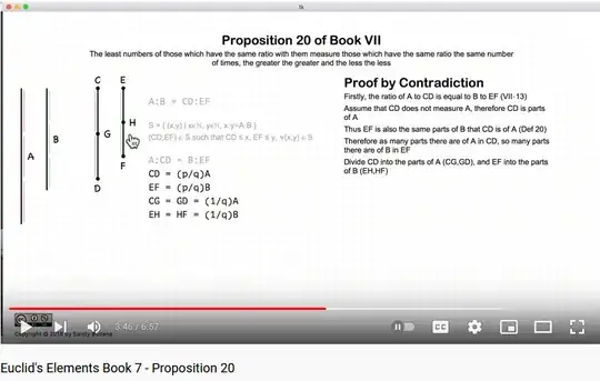

Below is a screen-shot of a video about the proof of Proposition 20 of Book VII of the elements. There is one step that I don't understand and seems to be completely glossed over by the proof. This is not a criticism of the video: many written sources around the internet give the same steps without the pictures, leaving me with the same problem. If anything the illustration in the video helped me pin-point exactly what my problem is.
The statement of the proposition is this:
Suppose $A$ and $B$ are positive integers and $CD$ and $EF$ are positive integers as well such that $A : B = CD : EF$ and moreover $(CD, EF)$ are the smallest pair $(x, y)$ such that $x : y = A : B$. Then $CD$ divides $A$ and $EF$ divides $B$.
The proof, as I understand it, goes as follows. We give a proof by contradiction, starting with numbers $A$, $B$, $CD$ and $EF$ such that $A : B = CD : EF$ and $CD < A$ but $CD$ does not divide $A$
  • There exist natural numbers $p$ and $q$ such that $q$ divides $A$ and $CD = p (A/q)$, or, as the video puts it: $CD = (p/q)A$. Since $CD < A$ we have $p < q$. All this is off course completely uncontroversial.
    • The assumption (that eventually must lead to a contradiction) that $CD$ does not divide $A$ translates in this language to $p > 1$.
    • The video uses, as an example $q = 3$ and $p = 2$ but explains that these are arbitrary examples and other numbers would be good as well
    • The quantity $(1/q)A$ is drawn in red in the picture
  • The point $G$ on segment $CD$ is defined by $CG = (1/q)A$.
    • By definition of $p$ we see that $G$ lies on $1/p$'th of $CD$ and since (by assumption) $p > 1$ we have that $G \neq D$ and $CG < CD$.
  • Next step: now that we have the number $q$ we can talk/think/reason about the mystery quantity $(1/q)B$.
    • This drawn green in the picture
    • Since, by definition, the mystery quantity fits exactly $q$ times in $B$, some completely standard and easy and innocent reasoning about ratios tells us that it fits exactly $p$ times in $EF$.
  • The point $H$ on segment on $EF$ is defined by $EH = (1/q)B$, so $EH$ is what I call the mystery quantity above.
    • Since moreover $p > 1$ we have that $H$ is not equal to $F$ and the mystery quantity $EH$ is smaller than $EF$.
  • Third step: by some completely standard and innocent reasoning that Euclid still manages to make sound complicated we conclude that $CG : EH = A : B$.
  • Final step: since $CG < CD$ and $EH < EF$ we get a contradiction with the initial assumption that $(CD, EF)$ is the smallest pair of numbers in ration $A : B$.
Now my question:
What tells us that the mystery quantity $(1/q)B$ is an integer???
Nothing in the proof depends on $EH$ being an integer except for the final step. We can still find that $EH < EF$ and that $CG : EH = A : B$ only now the 'contradiction' becomes the claim that some fraction is smaller than the smallest integer with a certain property which is of course no contradiction at all.
However if the proof does indeed define the mystery quantity $EH$ as $(1/q)B$ then there is no reason to assume that it is an integer, unless some extra proof that $q|B$ is provided. I can't find such extra proof in the video but maybe I am misinterpreting something?
Screen shot from the video illustrating the proof
The full video can be found here
PS Of course I can come up with a proof that $q|B$ (or of the full proposition) using the Fundamental Theorem of Arithmetic, but this proposition is used by Euclid as part of the proof of that theorem. So 'Well, duh, everybody knows about unique factorization into primes so no need to elaborate on this' could not have been what went through Euclid's head when putting this proof in the way he did.

When I translate that argument to the language of the video above we see it is very close and uses largely the same ingredients but there is a crucial difference: the points $G$ and $H$ are drawn on the lines $A$ and $B$ rather than on the shorter two. I spell out the argument below.
My (followup) question is:
Could it be that this is what Euclid was saying and that the video and/or written sources it relies on mixed things up, or does the argument in the video also work and am I still missing something?
The proof. We start in the same way as the text in the right part of the screenshot:
  • Firstly the ratio of $A$ to $CD$ is equal to $B$ to $EF$
  • Assume $CD$ does not measure $A$. Therefor $CD$ is parts of $A$
  • Thus $EF$ is also the same parts of $B$ that $CD$ is of $A$
  • Therefor as many parts of there are of $A$ in $CD$, so many parts there are of $B$ in $EF$
Now here is where I 'part' from the original. I take $n$ the largest number of copies of $CD$ that fit into $A$. The second bullet states that $x := A - n CD$ is not zero. It is however smaller than $CD$.
Very interestingly, by the third bullet this same number $n$ is also the largest number of times that $EF$ fits into $B$ so the number $y = B - n EF$ (which is obviously an integer because it was created using subtraction rather than multiplication and division) must be smaller than $EF$.
In the screen-shot the endpoints of $A$ and $B$ have no names so I will call them $A_1, A_2$ and $B_1, B_2$ respectively.
Draw point $G$ on $A$ so that $A_1G = x$ and so $A_2G = n CD$. Draw point $H$ on $B$ so that $B_1H = y$ and so $B_2H = n EF$.
We know that $A_1A_2 : B_1B_2 = CD:EF$ and since $A_2G = n CD$ and $B_2H = n EF$ we see that $A_2G : B_2H = CD : EF$ as well.
So we find:
$$A_1A_2 : B_1B_2 = A_2G : B_2H$$
from which it follows by an earlier proposition of Euclid (VII, prop 12) that the video uses as well at this stage in the same way (but applied to the other line segments)
That
$$A_1G : B_1H = A: B$$
But since we already saw that $A_1G < CD$ and $B_1H < EF$ and $CD, EF$ were supposed the smallest with the property of having ratio $A:B$ we get the desired contradiction as before.
