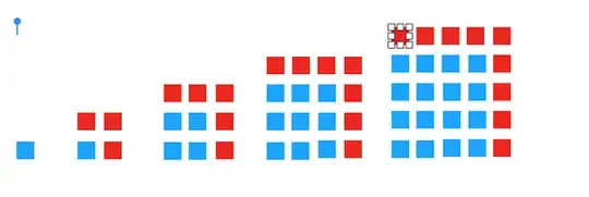

In other words, the sum of the first $n$ odd number is precisely $n^2$. It is nicely demonstrated in this picture I stole online:
Now stare at this photo. How can we derive the red layer without guessing patterns? Well, notice that the $n$th red layer consists of $n^2 - (n - 1)^2$ squares, which with a bit of algebra gives $2n - 1$ squares, precisely the summed term $2k - 1$ you got. Indeed, if we add up the first $n$ red layers, we will get the entire $n$th square.
