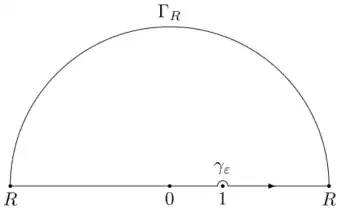

To analyze the behavior of this integral, we consider the counter-clockwise contour as below:
contour
Then, as $ R\to\infty $,
\begin{align*} 0 &= \lim_{R\to\infty} \oint_{\text{contour}} \frac{z^a}{(z-1)^2} \, \mathrm{d}z \\ &= I_{\varepsilon} + \int_{\gamma_{\varepsilon}} \frac{z^a}{(z-1)^2} \, \mathrm{d}z + \int_{-\infty}^{0} \frac{z^a}{(z-1)^2} \, \mathrm{d}z. \end{align*}
From this, we get
\begin{align*} I_{\varepsilon} &= - \int_{-\infty}^{0} \frac{z^a}{(z-1)^2} \, \mathrm{d}z - \int_{\gamma_{\varepsilon}} \frac{z^a}{(z-1)^2} \, \mathrm{d}z \\ &= - \int_{0}^{\infty} \frac{(-t)^a}{(1+t)^2} \, \mathrm{d}t + \int_{0}^{\pi} \frac{(1+\varepsilon e^{i\theta})^a}{(\varepsilon e^{i\theta})^2} \, i \varepsilon e^{i\theta} \mathrm{d}\theta \\ &= - e^{i\pi a} \int_{0}^{\infty} \frac{t^a}{(1+t)^2} \, \mathrm{d}t + \frac{i}{\varepsilon} \int_{0}^{\pi} (1+\varepsilon e^{i\theta})^a e^{-i\theta} \, \mathrm{d}\theta. \end{align*}
Using the binomial series and the identity $\int_{0}^{\infty} \frac{t^a}{(1+t)^2} \, \mathrm{d}t = \frac{\pi a}{\sin(\pi a)}$ together, we get
\begin{align*} I_{\varepsilon} &= - e^{i\pi a} \frac{\pi a}{\sin(\pi a)} + \frac{i}{\varepsilon} \sum_{n=0}^{\infty} \binom{a}{n} \int_{0}^{\pi} (\varepsilon e^{i\theta})^n e^{-i\theta} \, \mathrm{d}\theta \\ &= - e^{i\pi a} \frac{\pi a}{\sin(\pi a)} + \frac{i}{\varepsilon} \biggl[ 2 \varepsilon + i \pi a \epsilon - \sum_{k=1}^{\infty} \binom{a}{2k} \frac{2}{2k-1} \varepsilon^{2k} \biggr] \\ &= \bbox[border:2px #E0E0FF solid; padding:5px;]{\frac{2}{\varepsilon} - \frac{\pi a}{\tan (\pi a)} - \sum_{k=1}^{\infty} \frac{2 a(a-1)\cdots(a-2k+1)}{(2k)!(2k-1)}\varepsilon^{2k-1}} \end{align*}
