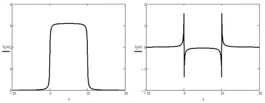

However, plotting each of these functions shows that the two functions do not yield the same result. Assigning some dummy numbers, say $a = 0$, $b = 10$, and $z=10$.
plot
The issue appears to be when $x$ is equal to either $a$ or $b$. Why is the trig identity not working in this case?

The identity $$\tan^{-1} q - \tan^{-1} r = \tan^{-1}\left(\frac{q - r}{1 + qr}\right)$$ has some limitations, due to $\tan^{-1}$ not being a proper inverse to $\tan$. In particular, the range of $\tan^{-1}$ is $\left(-\frac{\pi}{2}, \frac{\pi}{2}\right)$, and $\tan^{-1} q - \tan^{-1} r$ can easily be outside this range, e.g. if $\tan^{-1} q = \frac{\pi}{3}$ and $\tan^{-1} r = -\frac{\pi}{3}$. A more generally correct identity would be $$\tan(\tan^{-1} q - \tan^{-1} r) = \frac{q - r}{1 + qr}.$$ This implies the identity you wrote precisely when $$\tan^{-1} q - \tan^{-1} r \in \left(-\frac{\pi}{2}, \frac{\pi}{2}\right).$$ When $\tan^{-1} q - \tan^{-1} r > \frac{\pi}{2}$, we instead get: $$\tan^{-1} q - \tan^{-1} r - \pi = \tan^{-1}\left(\frac{q - r}{1 + qr}\right),$$ or similarly, we add $\pi$ if $\tan^{-1} q - \tan^{-1} r < -\frac{\pi}{2}$.

  • Thanks, I thought it might have something to do with the range of the function. Been away from my math classes for too long! – grfrazee Apr 13 '22 at 22:56
