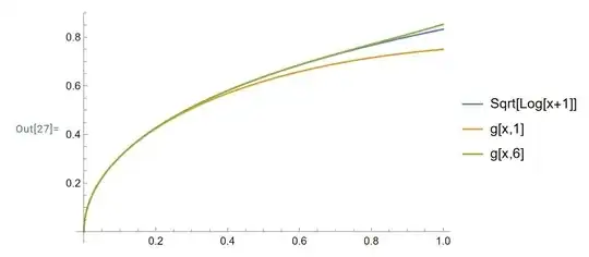

This series expansion can be evaluated by first writing $$ \log^{1/2}(1+x)=\left(\sum_{k=1}^\infty\frac{(-1)^{k-1}}{k}x^k\right)^{1/2}=\sqrt x\left(\sum_{k=0}^\infty\frac{(-1)^k}{k+1}x^k\right)^{1/2}. $$ Applying the well-known expansion for powers of power series we obtain $$ \log^{1/2}(1+x)=\sqrt x\sum_{m=0}^\infty c_m x^m, $$ where $c_0=1$ and $$ c_m=\frac{1}{m}\sum_{k=1}^m(k/2-m+k)\frac{(-1)^k}{k+1}c_{m-k}. $$ This series converges on $x\in[0,1)$ and is implemented in Mathematica as
c[0] := 1;
c[m_] := 1/m Sum[(k/2 - m + k) (-1)^k/(k + 1) c[m - k], {k, 1, m}];
g[x_, M_] := Sqrt[x] Sum[c[m] x^m, {m, 0, M}];
Here is a plot of $\log^{1/2}(1+x)$ compared to the truncated series expansion for $M=1$ and $M=6$:
Finally, here is a list of the first several coefficients $c_m$:
