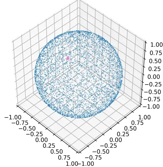

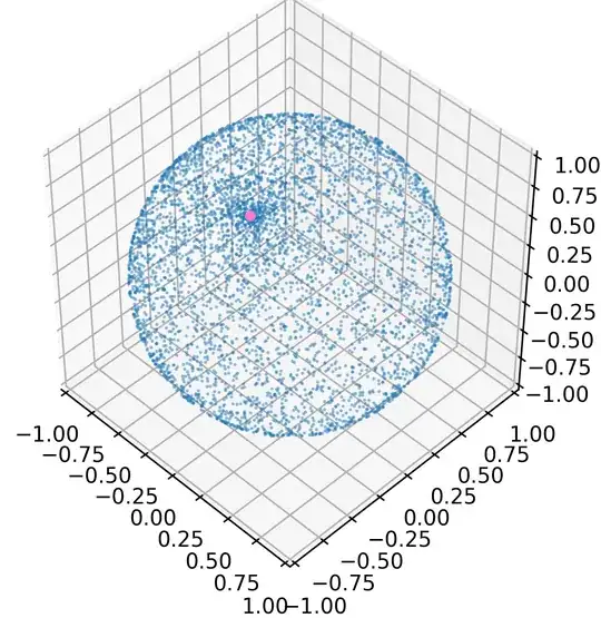

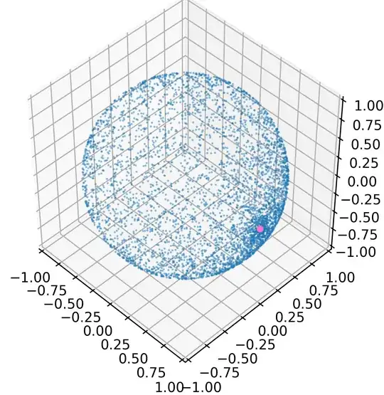

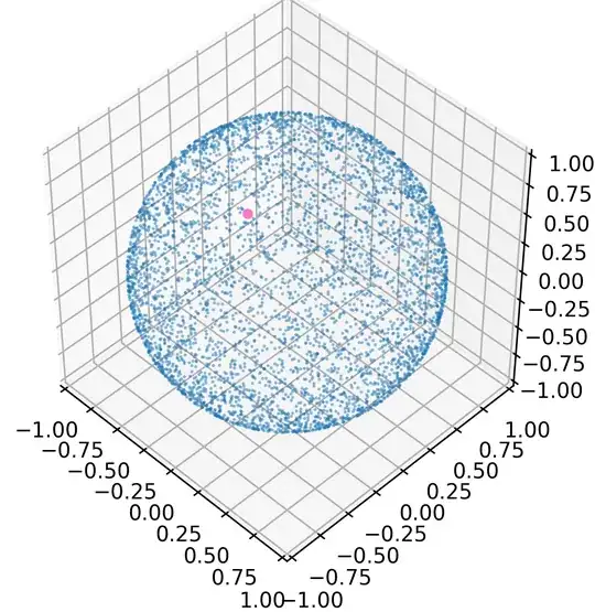

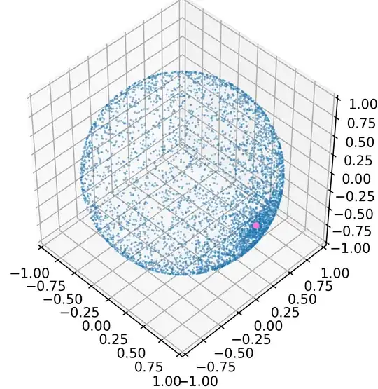

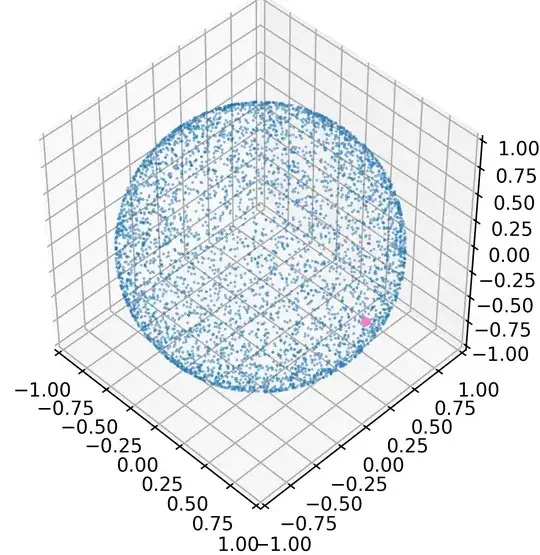

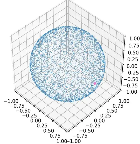

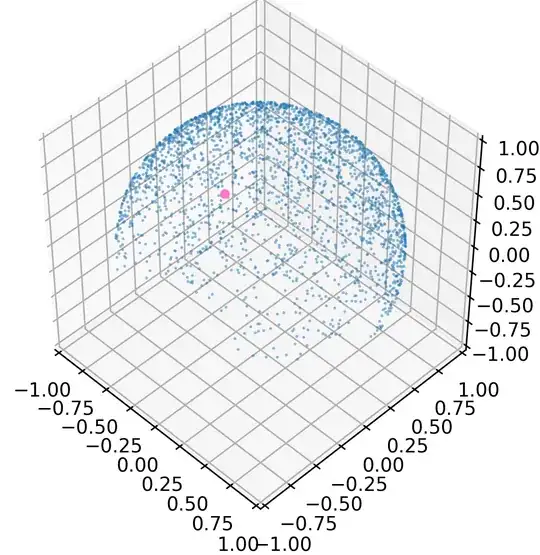

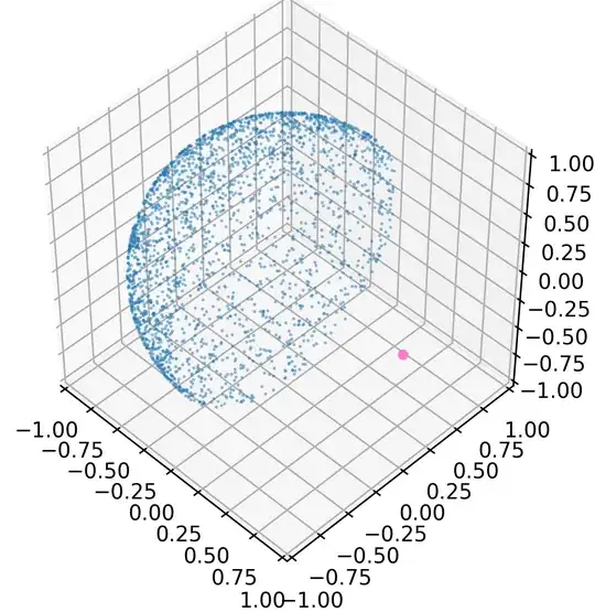

Empirical visualizations of various answers.
Initial
point
qr_full
randn_orthobasis
randn_axis
$\psi$ corrected
nbubis
$\psi$ corrected
randn_axis
$\psi \sim \mathcal{U}(0, 2\pi)$
nbubis
qr_half
$(1, 0, 0)$
$(\frac{1}{9}, -\frac{4}{9}, \frac{8}{9})$
The pink point denotes "initial" point. The blue points are the result of rotating the initial point using 5000 randomly generated 3x3 rotation matrices.

  • qr_half does not cover the full space of rotations.
  • qr_full corrects qr_half by randomly flipping the signs of the columns of the resulting rotation matrix, while imposing the required constraint $\det T = 1$ so that $T \in \mathcal{SO}(3)$.
  • randn_orthobasis generates two random vectors, and then generates an orthonormal basis from this by taking a bunch of cross products. A more generic orthonormalization method may be used instead for higher dimension matrices (e.g., 4x4, 5x5, ...).
  • randn_axis and nbubis both generate a random 3x3 rotation matrix using a spherically-uniform random axis vector, then a random angle of rotation about this vector. However, choosing $\psi \sim \mathcal{U}(0, 2\pi)$ has a counterintuitive consequence: the initial points are more likely to remain near their starting positions. To repair this, we must make it less likely to choose small angles by choosing $\psi \sim \frac{d}{du} \left( \frac{1}{\pi} (u - \sin u) \right)$, where $u \sim \mathcal{U}(0, \pi)$. In practice, we can use "inverse transform sampling" to sample from the corresponding CDF by simply interpolating over its inverse.
