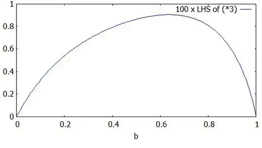

I don't know how to simplify this further but the plot below show that it is true for all $b \in [0,1]$.
So the inequality at hand is indeed true. In fact the inequality is strict except when $$\begin{cases} b = 0, &\iff (x,y,z) = (1,0,0) \text{ or } (0,1,0) \text{ or } (0,0,1)\\ b = 1, &\iff (x,y,z) = (\frac{1}{\sqrt{3}}, \frac{1}{\sqrt{3}}, \frac{1}{\sqrt{3}} ) \end{cases}$$
