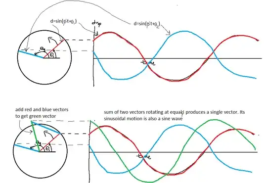

Excuse the messy sketch, but I think it should provide simple 'geometric' intuition. enter image description here
Penguino
  • 1,284
    That actually makes quite a lot of sense, thanks! I gotta mess with this in geogebra, never thought about trying something like that. – Habeeb M Mar 02 '22 at 22:57
    Yes - something like geogebra will certainly draw a better diagram than mine :). – Penguino Mar 02 '22 at 22:59
