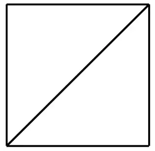

Now, it is a well-known fact that every finite abstract simplicial complex admits a "geometric realization", which is a Euclidean simplicial complex whose vertx scheme is simplicial isomorphic to our given complex. This is exactly the point which I do not quite understand. Why does there always exists an isomorphic simplicial complex which has the property that the intersection of two simplices is either a face or empty? It seems that this property in the definition of Euclidean simplicial complexes is much more restrictive, since for an abstract simplicial complex, the intersection of two simplices must not necessarily be again a simplex. For example, consider the following "triangulation" of the 2-torus:
where we glue together the top and bottom as well as the right and left. Now, this is a well-defined abstract simplicial complex, since the non-empty subset of any simplex is again a simplex. However, it is certainly not an Euclidean simplicial complex, since the intersection of the two triangles is the union of two edges and not again a simplex. So, how does this triangulation, viewed as an abstract simplicial complex, has a geometric realization?

    By gluing the top to the bottom and the left to the right in your square picture, you've identified all four corners. The resulting abstract simplicial complex would have just one vertex, say $v$. Each of the edges in your picture and each of the triangles would become just ${v}$. So your abstract simplicial complex would be unexpectedly simple, and its geometric realization would be just a single point. – Andreas Blass Mar 01 '22 at 16:00

  • @AndreasBlass : Indeed, that was not the best example. But the argument also works with the example drawn in this question: https://math.stackexchange.com/questions/821380/why-is-this-not-a-triangulation-of-the-torus. This is also clearly an abstract simplicial complex, but not an Euclidean one –  Mar 01 '22 at 17:36

  • One way to interpret the definition of an abstract simplicial complex is that simplices are determined by their vertices. For example given vertices $v \neq w$, there is only one $1$-simplex with vertices $v$ and $w$. In the picture at https://math.stackexchange.com/questions/821380/why-is-this-not-a-triangulation-of-the-torus, there are two edges with vertices $b$ and $e$, so this is not a simplicial complex. – John Palmieri Mar 01 '22 at 19:10
  • Yes, this I understand. Let me rephrase my question: Abstract simplicial complexes must not necessarily have the property that the intersection of any two simplices is either again a simplex or empty. For abstract simplicial complexes, just any subset of a simplex should be again a simplex, but I could in principle happen that the intersection of two simplices is a union of serval simplices. Now, the Theorem above states that any such abstarct simplicial complex admits an isomorphic Euclidean simplicial complex. But how is this possible? –  Mar 02 '22 at 19:51
  • I mean, isomorphic simplicial complex have kind of the same gluing pattern. So, how could an abstract simplicial complex which admits a pair of simplices whos intersection is neither empty nor a simplex have an isomorphic Euclidean complex, in which the intersection of any two simplices is either empty or another simplex? –  Mar 02 '22 at 19:52

But that statement is wrong: In an abstract simplicial complex, the intersection of two simplices is always either the empty set or a single simplex.
Here's the proof. Consider two simplices $\sigma_1,\sigma_2 \in \Delta$. Consider their intersection $\tau = \sigma_1 \cap \sigma_2$. Supposing that $\tau = \emptyset$, we are done. Supposing on the other hand that $\tau \ne \emptyset$, from the definition of intersection it follows that $\tau \subset \sigma_1$ (and that $\tau \subset \sigma_2$). From the definition of a simplicial complex, since $\sigma_1 \in \Delta$, and since $\tau \subset \sigma_1$, it follows that $\tau \in \Delta$. Therefore, $\sigma_1 \cap \sigma_2 = \tau \in \Delta$, that is to say, $\sigma_1 \cap \sigma_2$ is a simplex.
