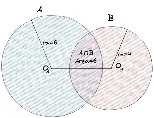

Say we have two intersecting circles we only know the areas of the circles and their intersection area. How can we find the distance between circle origins?
Looking for a generalized solution using r1,r2 and intersection area of circle A and circle B.

  • It's not clear to me what S(A/B) represents. Do you have a formula or method by which you can calculate the area of intersection, if you are given the radii of the two circles (and perhaps S(A/B))? – A.M. Feb 28 '22 at 22:52
  • S(A/B) is the intersection area of circle A and circle B. – hevi Mar 01 '22 at 00:10
  • What have you tried? Please show your work. – Math Lover Mar 01 '22 at 00:13
  • You can divide the intersection into two circular segments and get the intersection area from the distance between the centers. Maybe you can invert that. – Ross Millikan Mar 01 '22 at 00:13
  • @RossMillikan yes but looking for a generalized solution which only uses given r1,r2 and intersection area (or in other words area of A area of B and the intersection area). – hevi Mar 01 '22 at 00:18
  • Area of intersection of two general overlapping circles is the same question, but it also includes a formula (unfortunately incorrect) for the area in terms of the radii and distance between centers. It links to a page with correct formulas. – David K Mar 01 '22 at 02:37
  • @DavidK looking for a function f(r1,r2,S) which will give me the distance between circles origins – hevi Mar 01 '22 at 11:47
  • You've already defined the function. The reason for the first link is that its answer is the same as the answer I would put here: you will need to use numerical methods, which is a fancy way of saying trial and error (with some tricks to make the procedure more efficient). The key to the numerical methods is a correct formula for the area of overlap given the two radii and the distance. – David K Mar 01 '22 at 13:23
