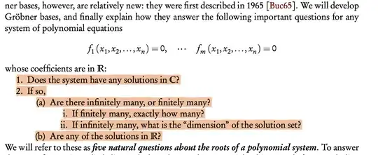

If a system of polynomial equations has infinitely many solutions over an algebraically closed field $\mathbb{C}$, what is the dimension of the solution set? How to analyze this question in general?
I am curious about this question, thus I found this tutorial, however it seems stops at the question $(a)i$, and does not give the answer of $(a)ii$, and $(b)$.
Could someone give a hint on this? Thanks a lot!
links to the tutorial: https://www.math.usm.edu/perry/old_classes/mat681sp14/gbasis_notes.pdf enter image description here
----------An update on the concept of dimension:----------
If there are infinitely many solutions to the polynomial system, the number of solutions does not make sense for counting solutions, instead, we need something else: dimension. In linear algebra, if the solutions to a linear system are infinitely many, then we care about how many basis are there to form the solution space, and the number of basis is called dimension of the solution space (am I right?). So, in polynomial systems, I am curious about the similar question, how to define such dimension?
In addition, I have read the chapter on structure of varieties, and found that:
  1. The solution set of polynomial system is defined (called) as algebraic variety
  2. Thus the dimension of solution set is the dimension of algebraic variety
  3. The dimension of algebraic variety $X$ is defined as the length of longest decreasing chain of irreducible sub-varieties of $X$ (refers to definition 3.2.8)
I am wondering whether this definition of dimension of variety is the thing that is similar to the example of linear algebra?
Moreover, regarding the dimension of solution set, how many possible definitions there exists?
(I am a very new beginner of algebraic geometry, and my intension is to understand how people characterize the solution set of polynomial equations, so that I can understand how to characterize solutions to the system in my hand.)
