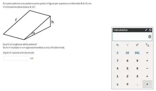

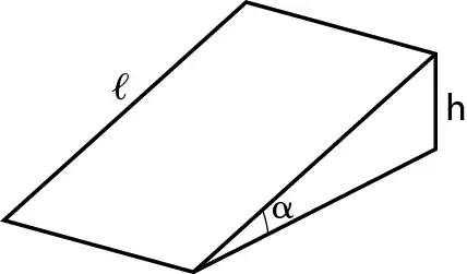

You want to build a platform like the one in the figure to overcome a height difference $h$ of 15 cm. The inclination must be 12°. What is the length $\ell$ of the platform? (the link is https://invalsi.zanichelli.it/taoDelivery/DeliveryServer/runDeliveryExecution?deliveryExecution=kve_de_https%3A%2F%2Finvalsi.zanichelli.it%2Ffirst.rdf%23i164517281905829660045946)
My students have not a scientific calculator during the test.
How can I solve the problem simply?
