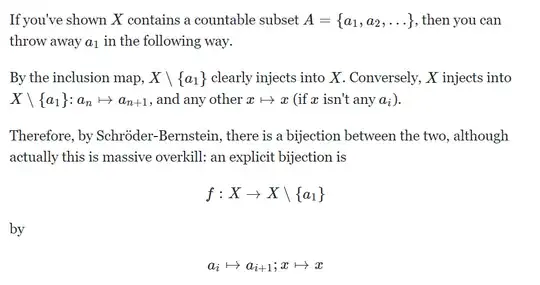

I have already read Proof that a set is infinite if and only if it has an infinite proper subset and this post does not provide an actual proof answer or assumes that the set is countable.
