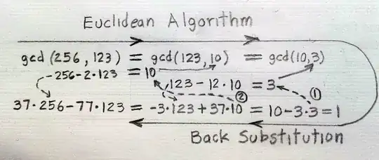

Below is an intuitive explanation of how back-substitution works in the extended Euclidean algorithm. In the top line of the diagram below we compute your $\,\gcd(256,123)$ using the common remainder based version of Euclidean algorithm $\,\gcd(a,b) = \gcd(b,\:\!a\bmod b)\ $ if $\, a\ge b$.
The second row in the diagram shows the remainder (mod) reductions used in each step, e.g. the first is one is $\,256\bmod 123 = 10,\,$ via $\,256 - 2\cdot 123 = 10,\,$ and the second one is $\, 123-12\cdot 10 = 3.\,$ The algorithm terminates when we reach $\,10\bmod \color{#c00}3 = 1$ via $\,10-3\cdot\color{#c00} 3 = 1,\,$ a Bezout equation for $\,\gcd(10,\color{#c00}3)=1$. Next we reverse the Euclidean steps to convert this to a Bezout equation for $\,\gcd(256,123) = 1$. The first back substitution step ${\textstyle \enclose{circle}{1\:\!}}$ reverses the reduction step $\,\gcd(123,10)\to \gcd(10,3)$, which used $\,123-12\cdot 10 = 3$ to replace $123$ by $3$. Reversing, we use the equation to replace $\,3\,$ by $\,123\,$ by substituting $\,\color{#c00}3 = 123-12\cdot 10\,$ into $\,10-3\cdot\color{#c00}{3}=1\,$ to get $\, -3\cdot 123 + 37\cdot 10 = 1,\,$ our Bezout equation for $\,\gcd(123,10)=1.\,$ Back step ${\textstyle \enclose{circle}{2\:\!}}$ proceeds similarly, we reverse the first step $\,\gcd(256,123) = \gcd(123,10)\,$ using $\, 256-2\cdot 123 = \color{#0a0}{10}\,$ by substituting for $\color{#0a0}{10}$ in our Bezout equation for $\,\gcd(123,\color{#0a0}{10}),\,$ viz $\,-3\cdot 123 + 37\cdot\color{#0a0}{10} = 1,\,$ yielding $\,37\cdot 256 - 77\cdot 123 = 1,\,$ the sought Bezout equation for $\,\gcd(256,123) = 1$.
