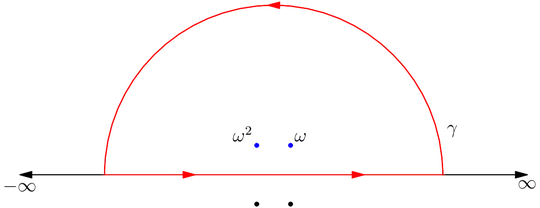

There's a very quick way to do it with complex analysis:
Consider the semicircular contour integral $$\int_{\gamma} \frac{dz}{1 + z^2 + z^4}$$ Example contour to integrate along around the poles $\omega = e^{i\pi / 3}$ and $\omega^2 = e^{2i\pi / 3}$. As the radius of the semicircle increases, the integral along the curved part decreases in magnitude, and the integral approaches $$\int_{-\infty}^\infty \frac{dx}{1 + x^2 + x^4},$$ twice our desired integral. By Cauchy's residue theorem, this will be $2\pi i$ times the sum of the residues at $\omega$ and $\omega^2$. By L'Hospital's rule, the residue at $\omega$ is $$\lim_{z \to \omega} \frac{z - \omega}{1 + z^2 + z^4}dz = \lim_{z \to \omega}\frac{1}{2z + 4z^3} = \frac{1}{\sqrt3i - 3} = -\frac{\sqrt3 i + 3}{12}.$$ Similarly, the residue at $\omega^2$ is $$-\frac{\sqrt3 i - 3}{12}.$$ Thus, $$\int_{-\infty}^\infty \frac{dx}{1 + x^2 + x^4} = 2\pi i\left(-\frac{\sqrt3 i + 3}{12} + -\frac{\sqrt3 i - 3}{12}\right) = \frac{\pi\sqrt3}{3}.$$ This means the desired integral equals $\pi \sqrt3 / 6$, so the answer is $\boxed 3$.
