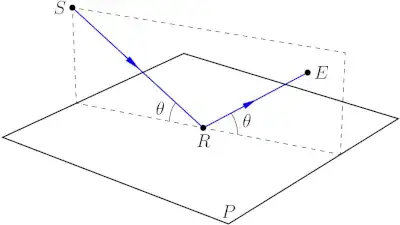

In a simple mathematical model, the surface of the pond is a plane $P$; the viewer's eye is a point $E$ "above" $P$. A point $S$ in the scene is visible to $E$ as a reflection in the pond if the following conditions are met:
  • There is a line segment from $S$ to a point $R$ (from which a light ray reflects) of the visible part of $P$ that does not hit any scene elements;
  • The points $S$, $R$, and $E$ lie in a plane perpendicular to $P$, and the segments $SR$ and $RE$ make equal angles with $P$ at $R$:
Reflection in a planar surface
The angle in the diagram is exaggerated for clarity, and it varies for different points in the scene. It may help to imagine yourself being at a point on the surface of the water looking up at angle $\theta$ toward the tall tree; do you see the top of the tree, or just the bank?
  • https://i.sstatic.net/sgRpj.jpg So angle A and angle B are the same. Whatever they include will be "seen?" I think I understand. Angle B is set by simple geometry, as with angle A. Distances and heights are a must. – jackwarner Jan 22 '22 at 17:30
  • Yes, that's right ($A = B$ in the linked image). – Andrew D. Hwang Jan 22 '22 at 18:33
