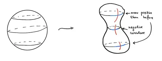

There are a number of ways to interpret or generalize this statement. For instance, since $2\pi \chi(M)$ is a purely topological quantity, this tells us that stretching or deforming $M$ through smooth isotopies will not change the integral of the Gaussian curvature. So, we could take a sphere $S^2(r)$ of radius $r$ in $\Bbb{R}^3$. Then the Gaussian curvature is everywhere $\frac{1}{r^2}$. The integral is $$ \int_{S^2(r)}\frac{1}{r^2}\mathrm{vol}=\frac{4\pi r^2}{r^2}=4\pi=2\pi\chi(S^2(r)). $$ Now, we can deform this sphere $S^2(r)$ as we wish through isotopies and we see that the Gauss-Bonnet theorem gives us a "conservation law":
if we deform our surface $M$ in a volume-preserving manner such a way that the curvature in one region becomes greater, then the curvature in another region must become smaller.
Drawing a picture illustrates this idea:
This is a nice intuition for at least some of what the theorem is saying. However, there is another interpretation. Indeed, we have a classical topological invariant $\chi(M)$, and with some work we were able to find a "geometric quantity" to integrate to return $\chi(M)$, establishing a connection between a global geometric quantity and a topological quantity. This can be interpreted as $$ \int_M\frac{K}{2\pi}\mathrm{vol}=\chi(M). $$ Now, the natural objects of integration on manifolds are differential forms and indeed we have integrated a $2-$form $\frac{K}{2\pi}\mathrm{vol}$ to return $\chi(M)$. This is a closed $2-$form and defines a cohomology class $\omega\in H^2(M,\Bbb{R})$. So, we arrive at a natural question:
