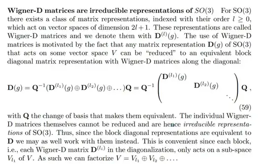

I'm reading the following text which is describing the irreducible representations of $SO(3)$ that are associated to so called Wigner-D Matrices.
'..any matrix representation $\textbf{D}(g)$ of $SO(3)$ that acts on some vector space $V$..'
Can the group $SO(3)$ act on a more general vector space $V$ that is not $\mathbb{R}^3$? To me this sounds weird. I would describe a representation of $SO(3)$ as a map
$$\rho : SO(3) \rightarrow GL_3(\mathbb{R})$$
So for each fixed $g \in SO(3)$, $\rho(g):\mathbb{R}^3 \rightarrow \mathbb{R}^3$ describes a rotation matrix.
In the document above it is stated that the irreps of $SO(3)$ are indexed by a $l \ge 0$ such that any rotation (a general representation that I've described above) can be decomposed as a direct sum of representations acting on suitable vector spaces of dimension $2l+1$. If we take $l=2$ does it make any sense to consider $\rho(g)^{(5)}:\mathbb{R}^5 \rightarrow \mathbb{R}^5$ ?
I mean, the group is about 3D rotations... Maybe I'm just pretty confused about it.

I wanted to explore José's answer in the context of the passage of the text book. In other words, believing the textbook, what does it say about José's example?
