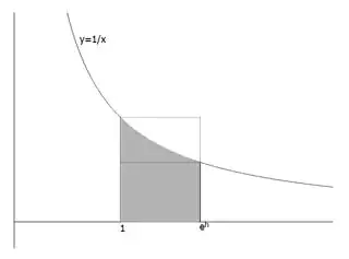

I think if you've seen the definition of the derivative, this question usually wants you to recognize the connection between the derivative of $e^x$ at $0$ and the $\lim\limits_{x\to 0} \frac{e^x-1}{x}$, but I believe if you know the definition of the natural logarithm and that the exponential function is it's inverse, there is a geometric argument based simply on the graph of $y=1/x$ below which doesn't actually use calculus. Note that the area of the shaded region is $h$, so
$$ (e^h-1)\cdot 1\ge h\ge (e^h-1)\cdot e^{-h}$$ $$ 1\ge \frac{h}{e^h-1}\ge e^{-h}$$ $$ 1\le \frac{e^h-1}{h}\le e^{h}$$
Now let $h\to 0$. Of course you have to have factored the numerator and taken out the constant factor from your original expression as discussed in the comments.
I guess that really only gets you ${h\to 0^+}$, but it shouldn't be too hard to fix.
