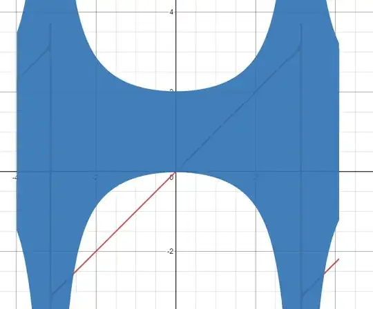

Not an answer, but just a visual demonstration: the red curve is the Fourier series of $f(x)=x$ summed to $1000$ terms; the blue... blob... is Desmos's attempt after two minutes of calculation to plot $f'(x)$. Some nonsense indeed.
More formally, consider the piecewise differentiation:
$$2\sum_{n=1}^\infty\frac{(-1)^{n+1}}{n}\sin(nx)\mapsto2\sum_{n=1}^\infty(-1)^{n+1}\cos(nx)$$
Where we note the distinct lack of a dividing $1/n$ term! This means the resulting series simply doesn't settle down, as the amplitudes are never regulated, hence the blobby nonsense below.

  • The series above sums to $1$ except at $\pm \pi$ by various summability methods (Abel,Caesaro) but it cannot converge anywhere since the terms do not go to zero – Conrad Jan 13 '22 at 18:33
