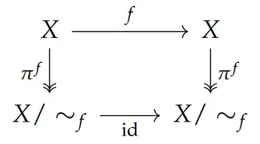

For $f:X\to X$ an idempotent, define an equivalence relation $\sim_f$ on $X$:
$$x\sim_f y\iff x=y \quad\text{ or }\quad f(x)=y\quad\text{ or }\quad x=f(y) \quad\text{ or }\quad f(x)=f(y).$$
(Reflexivity and symmetry of this relation is straightforward; for transitivity one can draw a $4\times 4$ table whose columns are all possibilities for $x\sim_f y$ and whose rows are all possibilities for $y\sim_f z$; idempotence of $f$ is important here. Succinctly, $y\sim_f x \iff y\in f^{-1}(f(x))$, that is, $y$ is in the $f$-saturation of $x$.)
Let us denote by $\pi^f:X\twoheadrightarrow X/\sim_f$ the canonical projection to the associated quotient set. Since $f(x)=f(x)$, $f(x)\sim_f x$, so that $f/\sim_f = \operatorname{id}$, i.e.
In particular, for $f=\alpha_e$, $\underline{\alpha_e}: X/\sim_{\alpha_e}\to X/\sim_{\alpha_e}, [x]\mapsto [\alpha_e(x)]$ is the identity map. Finally for $t\in M$, $\alpha_t$ preserves $\sim_{\alpha_e}$, so that
$$\underline{\alpha_t}: X/\sim_{\alpha_e}\to X/\sim_{\alpha_e},\,\, [x]\mapsto [\alpha_t(x)]$$
is well-defined. It is straightforward that now we have a monoid action $\underline{\alpha_\bullet}: (M,e)\to \left(\operatorname{End}_{\text{Set}}(X/\sim_{\alpha_e}),\operatorname{id}_{X/\sim_{\alpha_e}}\right)$.
