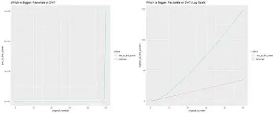

Using the R programming language, I made a plot of these $N!$ vs $2^N$:

g1 = ggplot(table, aes( original_number )) + geom_line(aes(y = two_to_the_power, colour = " two_to_the_power")) + geom_line(aes(y = factorials, colour = "factorials")) + ggtitle("Which is Bigger: Factorials or 2^n?")
g2 = ggplot(table, aes( original_number )) + geom_line(aes(y = log(two_to_the_power), colour = " two_to_the_power")) + geom_line(aes(y = log(factorials), colour = "factorials")) + ggtitle("Which is Bigger: Factorials or 2^n? (Log Scale)")
plot_grid(g1, g2)
Based on this plot, it seems that $N!$ is initially smaller, bu soon $N!$ becomes far bigger than $2^N$.

    "it seems that $N!$ is initially bigger, but $2^N$ soon grows way bigger than $N!$" $;-;$ That's the opposite of what the graph you posted shows. Think of it, if you multiply $2$ to itself $N$ times, how do you expect it to compare vs. multiplying an ever increasing sequence of numbers from $1$ to $N$ the same number of times? – dxiv Dec 30 '21 at 08:04
  • If you just want to prove $n!>2^n$ for $n\ge 4$, you can use induction. That $n!>>2^n$ for large $n$ can easily be seen by considering that we get the next entry of the sequence $\frac{n!}{2^n}$ by multiplying with $\frac{n+1}{2}$ , which gets bigger in each step. – Peter Dec 30 '21 at 09:08
Based on this plot, it seems that N! is initially bigger, but 2^N soon grows way bigger than N!.
Then your plot is wrong, or better yet, you just misread it or you mistyped what you wanted to say.
