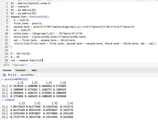

What if $X$ is an arbitrary $n \times 1$ real vector? Actually, I already calculate those term with R and it turns out when $X$ is a vector, that theorem went wrong. But I am not sure about my result.

I also attach my R studio result imageR studio code

  • @user1551 I also thought same as you, but as you can see in my R studio result image, they don't match. – someeed Dec 29 '21 at 12:02
  • Oh, no, the cross terms are missing in (10). Formula (8) is correct, though. – user1551 Dec 29 '21 at 13:48
  • @user1551 what do the cross terms are missing in (10) mean?? – someeed Dec 30 '21 at 00:08
  • Let $P=VV^+$. It is the orthogonal projection onto the range of $V$. We can decompose $XX^T$ into the sum $PXX^TP+PXX^T(I-P)+(I-P)XX^T+(I-P)XX^T(I-P)$ (where $(I-P)XX^T(I-P)$ can also be written as $X_\perp X_\perp^T$). Apparently, the authors have mistaken $XX^T$ as $PXX^TP+(I-P)XX^T(I-P)$. – user1551 Dec 30 '21 at 13:24
