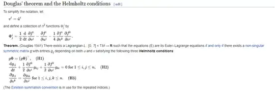

After looking around, I found the inverse problem for Lagrangians giving the Helmholtz conditions. Let us define $f^{A}(x^{A}, x^{B}) = \gamma\cdot (x^{A} + x^{B})$ and $f^{B}(x^{A}, x^{B}) = -\gamma\cdot (x^{A} + x^{B})$ as in the wiki page, and let us define $$\Phi_{j}^{i} = \frac{1}{2} \frac{\mathrm{d}}{\mathrm{d} t} \frac{\partial f^{i}}{\partial \dot{x}^{j}} - \frac{\partial f^{i}}{\partial x^{j}} - \frac{1}{4} \frac{\partial f^{i}}{\partial \dot{x}^{k}} \frac{\partial f^{k}}{\partial \dot{x}^{j}}.$$ Here we easily obtain $$ (\Phi_{j}^{i}) = \begin{pmatrix} -\gamma & -\gamma \\ \gamma & \gamma \end{pmatrix}. $$ Now the wiki page says that we need to find a non-singular symmetric matrix $g = (g_{ij})$ such that conditions $(\text{H}1)$-$(\text{H}3)$ in the wiki page are satisfied (see image at the bottom for conditions). I found that $$ g = \begin{pmatrix} 1 & \frac{3}{2} \\ \frac{3}{2} & 2 \end{pmatrix} $$ works, so I concluded that there should be a Lagrangian for my differential equations. However, I have not been able to find such any desired function that works.
Questions:
  • Was my above reasoning in determining that a Lagrangian exists correct? Did I make a correct application of Douglas's theorem?
  • Can anyone help me find a Lagrangian? I tried various functions, yet they all failed to produce the differential equations.
  • If no one can give me an explicit answer, then can anyone tell me what steps I should take to construct a Lagrangian?

  • Relevant wikipedia image as of 12/6/2022 in case it gets edited: enter image description here

To answer Question 2: The role of $g$ in Douglas's theorem appears to be to "symmetrize" the potential terms. (I gleaned this from the condition (H1) in the Wikipedia article.) In particular, the fact that $g \Phi = (g \Phi)^T$ implies that multiplying a column vector containing the given equations by $g$ would be fruitful. Doing this yields \begin{align*} \ddot{x}_{A} + \frac{3}{2} \ddot{x}_B + \frac{1}{2}\gamma(x_{A} + x_{B}) &= 0 \\ \frac{3}{2} \ddot{x}_A + 2 \ddot{x}_{B} + \frac{1}{2} \gamma(x_{A} + x_{B}) &= 0 \end{align*} and so it seems that the desired Lagrangian is $$ L = \frac{1}{2} \dot{x}_A^2 + \frac{3}{2} \dot{x}_A \dot{x}_B + \dot{x}_B^2 - \frac{1}{4} \gamma (x_A + x_B)^2. $$
As an aside, note that the above "kinetic term" is not positive definite. This may or may not be relevant for your purposes.
For future reference I recite your differential equations \begin{align} \frac{d}{dt}\frac{\partial L}{\partial \dot{x}_{A}} - \frac{\partial L}{\partial x_{A}} = \ddot{x}_{A} - \gamma(x_{A} + x_{B}) \tag{EL1}\\ \frac{d}{dt}\frac{\partial L}{\partial \dot{x}_{B}} - \frac{\partial L}{\partial x_{B}} = \ddot{x}_{B} + \gamma(x_{A} + x_{B})\tag{EL2} \end{align}
