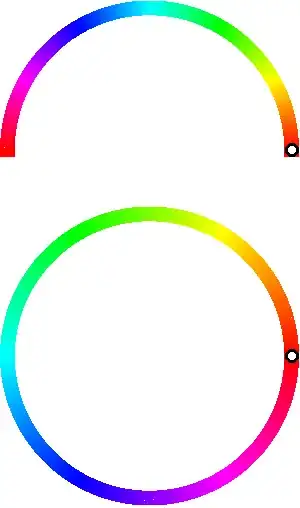

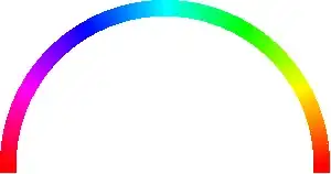

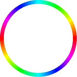

Identify antipodal points on the circle:
Form the identification space:
Moving along this space, you come back to where you started... just like on a circle:
(original gifs here and here; I joined them because when they load at different times in the browser, they don't stay in sync)
This correspondence between the points of $P$ and the points of $S^1$ is a homeomorphism.

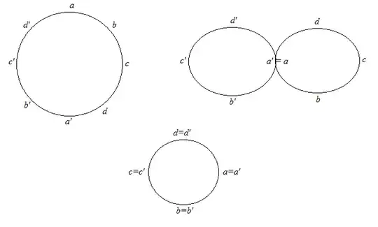

Start with $S^1$, as in the first figure below. Hold it at $c'$ and $c$, and flip the righthand side over to form an $\infty$ sign, as in the second figure. Now fold the loops together into a single loop, as in the third figure. Everything matches up properly to give you your quotient space: it’s $S^1$ again.
