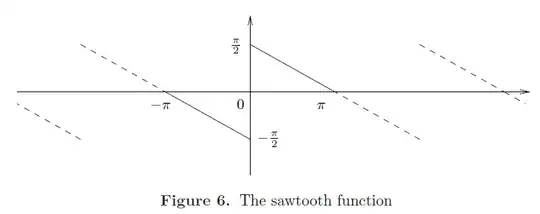

My question stems from Exercise $8$, in Chapter $2$ of Stein and Shakarchi's Fourier Analysis. I have verified that $$\frac{1}{2i} \sum_{n\ne 0} \frac{e^{inx}}{n} = \sum_{n\ge 1} \frac{\sin nx}{n}$$ is the Fourier series of the $2\pi$-periodic saw-tooth function defined by $f(0) = 0$, and $$f(x) = \begin{cases} \frac{-\pi-x}{2} & -\pi < x < 0\\ \frac{\pi - x}{2} & 0 < x < \pi\end{cases}$$ enter image description here
