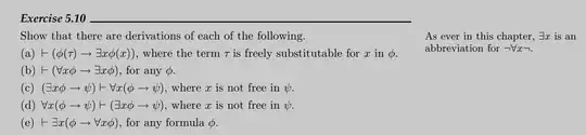

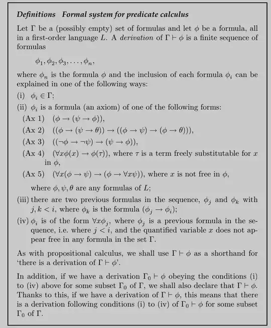

I am tasked to find a proof of $\vdash \exists x (\phi \implies \forall x \phi)$ by using the Hilbert axioms. I've been trying for about 2 hours. I tried using the results from the previous parts of the exercise below. I am also allowed to use substitution instances of tautologies (i.e $\vdash p \implies p$ implies $\vdash \phi \implies \phi$ where $p$ is a propsitional variable and $\phi$ is a first-order formula), that $\exists x$ is defined as $\neg \forall x \neg$, and the standard meta-theorems like proof by contradiction.
Basically I've tried to work backwards:
$$\vdash \exists x (\phi \implies \forall x \phi)$$ $$\vdash \forall x (\phi \implies \forall x \phi)$$ $$\vdash (\phi \implies \forall x \phi)$$
This last step seems impossible to prove, as it would have me show that if a property is true for some x then it is true for all $x$ (obviously not true if $\phi$ is taken to be "is even")
Similarly I tried invoking part (c)
$$\vdash (\exists x \phi \implies \forall x \phi) \implies \forall x(\phi \implies \forall x \phi)$$
Again, this would require to show that if a propery is true for some x then it is true for all $x$.
The only other way to introduce an $\exists$ as the "main connective" is by (a). But that seems to go nowhere as well.

  • @mohottnad I believe you are referring to Rule (iv) in the image. If I have $\vdash \phi(x)$ then I can derive $\vdash \forall x \phi(x)$ by Rule (iv). Then I could use Axiom 1 and write $\vdash \forall x \phi(x) \implies ( \phi(x) \implies \forall x \phi(x))$. Then I could use modus ponens to get $\vdash \phi(x) \implies \forall x \phi(x) $. From there I can get $\vdash \forall x (\phi(x) \implies \forall x \phi(x)) $ by Rule (iv) and finally $\vdash \exists x (\phi(x) \implies \forall x \phi(x))$ by Ex. (b). But, this is based on the premise $\vdash \phi(x)$, which I am not given. – ngc1300 Dec 13 '21 at 04:40

  • Step 2 seems incorrect: $x$ is free in $\phi$, so Axiom 5 does not apply. – Vladimir Sotirov Dec 13 '21 at 08:38
