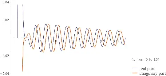

Another example which has an imaginary part greater than $1$:
$$\sum_{n\ge1} \text B_\frac n2 (-n,n)i^n=-\sum_{n\ge 1} \frac{(-1)^n (2-n)^n}{n^{n+1}}=-0.0078824-1.004251…i$$
which converges pretty slowly with this summand graph:
