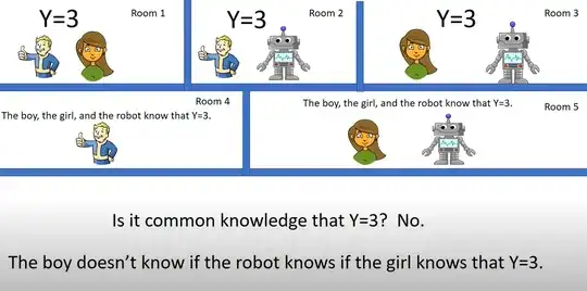

So good so far, but when trying to applicate this formalism to a practical use case, I'm missing the right impetus. I found a very simple and illustrative example in this YT video "Is It Common Knowledge?" (by James Miller):
I would really appreciate it if someone can help me how to use the (admittedly simple) formalism to describe this use case.
My rough ideas are:
  • I have to define the three "decision makers", the boy ($i=1$), the robot ($i=2$) and the girl ($i=3$). This is our starting point.
  • I have to define $S$ and the partitions $P_1,P_2,P_3$. Here I already have difficulties.
  • For our boy, robot and girl we have to define the knowledge functions $K_1,K_2,K_3$.
  • To describe that "$Y=3$" is not common knowledge, we have to intersect $K_1(e)\cap K_2(e)\cap K_3(e)$, use the iteration $K_1(K_2(K_3(e)))$ and come up with an result that is an empty set $\emptyset$.
I would be grateful if one could help me to put the puzzle pieces together.
